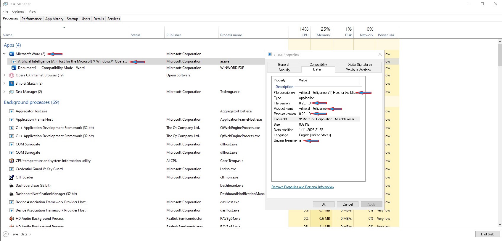

Ok everyone. Here are my findings on my Windows 10 Pro machine with Office 2021 Professional installed. I manually updated my product a bit ago. Please review the screenshot below:
*Please note that I am NOT on Norton version 24.xx, having reverted to version 22.24.8.36. The file aswhook.dll is NOT present in this version of Norton 360 Deluxe. Version 24.xx has the aswhook.dll file installed and it appears I have been half wrong about ai.exe in at least one manner.
The digital certificate for the file ai.exe IS VALID. Therefore that being said, I need to ask at least one of you to find the file ai.exe on your install. Right click on the file and select “Properties”. Open the tab labeled “Digital Signatures”. Please get a screenshot of that and post here for review. This will give us the opportunity to review and send the finding to the team who is looking into the issue. The error .

Looking at both screenshots now. Thanks for posting them. My apologies for the tardiness, I’m battling a case of RSV the moment, getting on the forums here and there as I can muster the energy. :grinning:
The aswhook.dll signatures look good. Earlier in the thread I had posted where the 24H2 may be the culprit or a part of it. Clc is on 23H2 and has the issue so that may rule that out for some. Still there is a common cause to find.
