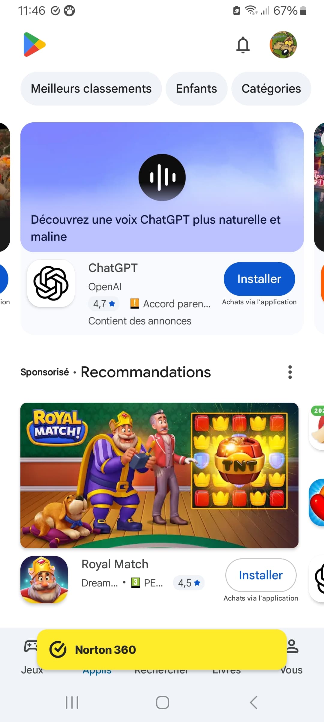

Google Play Store itself does not render continuous rotating ads, nor is this behavior normal for the official application. Experiencing continuous ads that rotate the screen or automatically open the Play Store is typically caused by third-party apps displaying intrusive ads, malware, or ad-supported games that use aggressive ad networks.
Common Causes and Solutions:
- Third-Party App Ads: Many free apps and games display ads that may force the screen to rotate or redirect to the Play Store to promote other apps. Users report that ads in games can rotate the screen even when auto-rotate is disabled, making it difficult to close them.
- Malware or Fake Apps: Intrusive ads that interfere with normal app use or continuously redirect to the Play Store are often linked to fake or malware apps downloaded from the Play Store. These apps may have been mistakenly approved or are disguised as legitimate software.
- Ad Networks and Dark Patterns: Some ads use “dark patterns” to trick users into clicking, resulting in automatic redirects to the Play Store. This is considered a feature of the ad network serving the content, not the Play Store itself.

The official Play Store displays static sponsored app recommendations (clearly marked as “Sponsored”) within search results or on the main feed, but these:
- Do not rotate your screen automatically.
- Do not force full-screen takeovers that interrupt other apps.
- Do not appear continuously in a loop.
What is actually happening: The behavior you are seeing—continuous rotation and intrusive pop-ups—is a hallmark of aggressive adware or a malicious third-party app installed on your device. These apps often:
- Mimic System Behavior: They disguise ads as system notifications or Play Store updates.
- Force Rotation: They trigger screen rotation to make the “Close” button hard to reach or to force an accidental click.
- Loop Ads: They are programmed to serve ad after ad until the user interacts or the app is closed.
Conclusion: This is a security issue, not a feature. You should treat this as a sign that a malicious app is active on your phone. Immediate action (using Private DNS like dns.adguard-dns.com and scanning with Malwarebytes ) is required to stop it.
