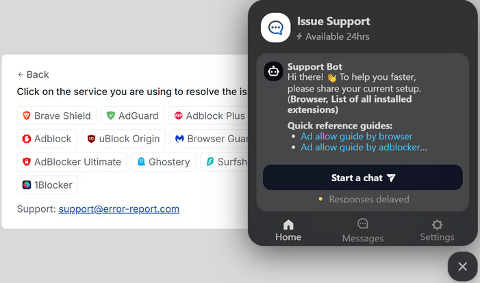

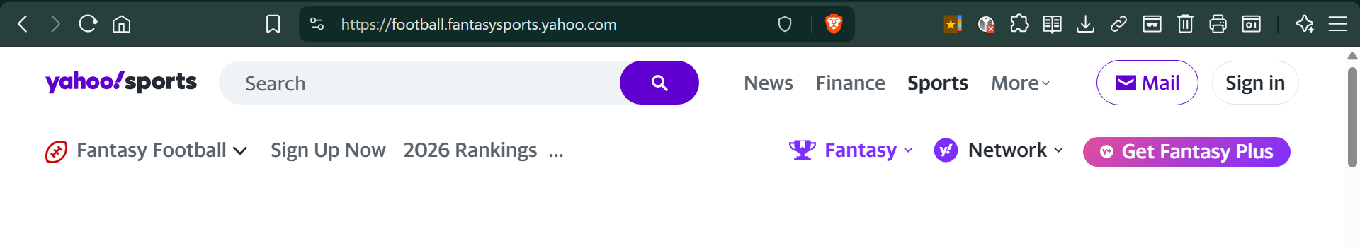

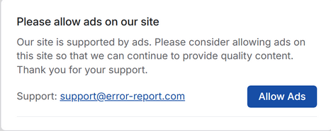

Detailed description: On Yahoo Fantasy Football pages keep getting redirected to report.error-report.cahm and then it refuses to connect (it’s really dot com but I can’t prevent the link if I use it). I can’t do anything in Yahoo Fantasy. I will not turn off add blocker. How do I get this to stop?

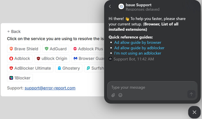

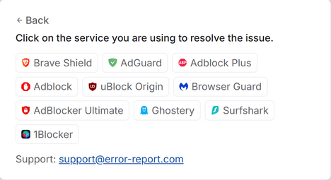

report.error-report.com/ is an anti-adblock redirect page used by certain websites to circumvent ad blockers
How It Works
Ad Scripts Fail : Websites load ads from domains like html-load.com.
Blockers Intervene : Ad blockers stop these scripts from executing.
Scripts Trigger Alert : An inline script detects the blockage.
Users Are Redirected : The site redirects you to error-report.com.
The Pitch : The page blames your ad blocker for “breaking” the website.
The Ask : It requests that you allowlist their domains to “fix” it.
How to Deal with It
If you are running into this loop while trying to browse, you can report the broken page to filter maintainers or tweak your extensions:
Update Filters : Force an update on your uBlock Origin or AdGuard Filters.
Defuse Scripts : Advanced users can create custom rules to bypass the inline scripts.
Report the Site : Use your ad blocker’s “Report an issue” tool to notify filter developers.
This happens because Yahoo Fantasy Football heavily utilizes programmatic scripts that conflict with your ad blocker. When your blocker restricts their tracker domains, Yahoo’s anti-adblock script forces the aggressive report.error-report.com redirect to try to make you turn it off.
