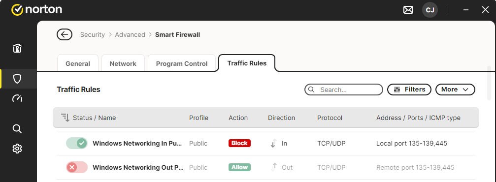

Blocking Outbound SMB Ports in the Public Profile
The screen print below shows the default firewall rules for SMB in my Norton installation. There are no other rules related to these ports configured in my Norton installation.
To me it is obvious that inbound SMB ports are being blocked for the Public profile by the first rule below.
However I do not understand how the second rule below (that is disabled by default and cannot be changed) blocks outbound traffic to these same SMB ports.
Can someone please explain this and tell me if outbound traffic to the SMB ports are actually being blocked or not for the Public profile.
Hello @carjimz
In your Norton Smart Firewall, outbound traffic to SMB ports is typically NOT being blocked for the Public profile by default, despite the appearance of that second rule.
Understanding the Rules
The behavior you are seeing is due to how Norton handles its default traffic rules:
  • Rule 1 (Active): Explicitly blocks Inbound SMB traffic when your network is set to the Public profile. This prevents other computers on a public network (like a coffee shop) from seeing or accessing your shared files and printers.
  • Rule 2 (Disabled): This “SMB Windows 2000” rule is a legacy placeholder that is disabled by default. Because it is Disabled, it performs no action—it does not block or allow traffic.
Why is Outbound SMB Allowed?
Norton 360 Smart Firewall is designed to allow standard outbound communication by default so that you can still browse the web or connect to remote resources.
  • Implicit Allow: If there is no active rule explicitly blocking “Outbound” traffic on ports 445 or 137-139, the firewall generally allows those requests to pass.
  • Purpose: This allows you to connect to a remote server or NAS from your computer, even if you don’t want that same server to initiate a connection back to you.
Summary of Status for Public Profile
Traffic Direction Status Reason
Inbound SMB Blocked Active default rule specifically for the Public profile.
Outbound SMB Allowed No active rule exists to block it; the second rule you see is disabled.
If you specifically want to block your computer from sending SMB traffic out while on a Public network, you would need to manually create a new Traffic Rule set to “Block,” “Outbound,” and the “Public” profile.
While the user interface has received updates in Norton 360 v24+ version, the underlying logic of the Smart Firewall remains consistent regarding default traffic rules.
In Norton 360 v26, the firewall still uses Automatic Program Control as its primary mechanism:
  • Rule Logic Still Holds: The “SMB Windows 2000” rule remains a legacy component. If it is Disabled in your Norton 360 v26 settings, it continues to have no effect on your traffic.
  • Outbound remains “Allow by Default”: Norton 360 v26 continues to prioritize outbound connectivity to ensure your applications can reach the internet and local resources. Unless a specific active rule blocks “Outbound” traffic for a profile, it is permitted.
  • Public Profile Protection: The active rule blocking Inbound SMB on the Public profile is a core security feature that has not been changed in the latest versions to ensure devices remain “stealthed” on untrusted networks.
