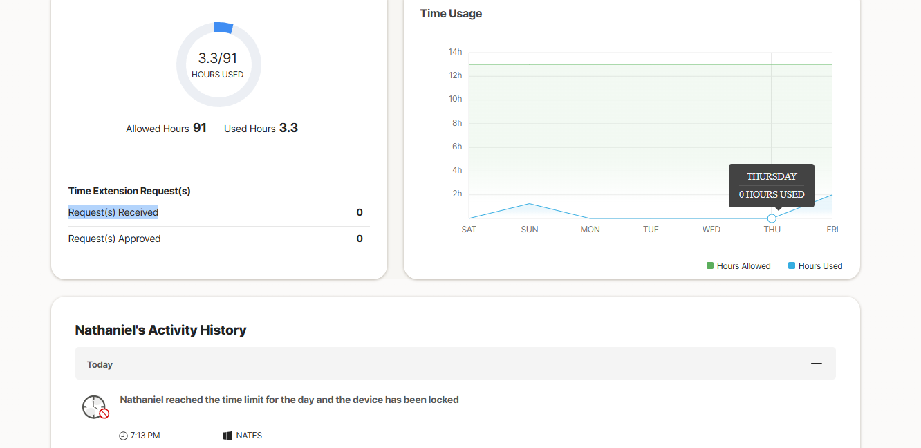

Childs daily time limit is set to 13 hours, it shuts off after 2
Issue abstract: My sons norton family is set to 13 hours a day because of this issue and it still doesn’t work.
He is set to 13 because I was trying to give him more hours. It literally locks him out after 2 hours, saying he has 11 left but shows device as locked. and locks it. There is no option to manually add a few hours for the day temporarily either. This app is not intuitive at all if this is how its meant to work.
Norton Family
Windows 11
No Error., but shows the meter at 2 of 13. And device is locked as its out of time?
If this is working as intended, how do I get a refund because the free version of google family works far better for this apparently. I can literally hit one button and say add time and choose how much. This has nothing. Also where do I download the app for the parent pc windows 11 so I dont have to use a website like 1995. Lol. thank you.
