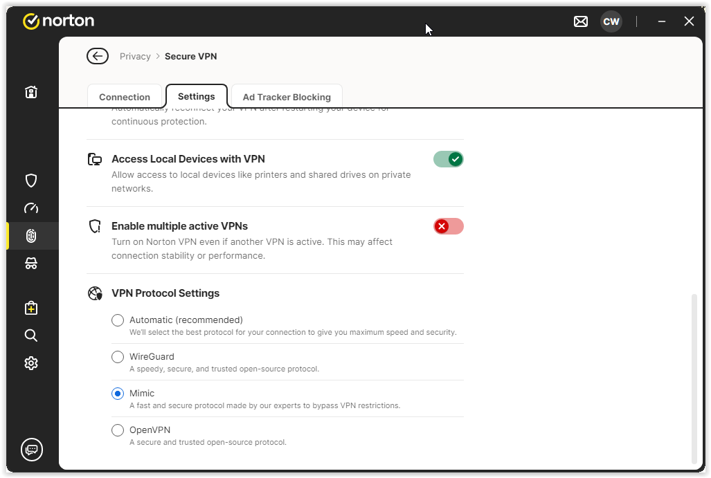

WireGuard is used by default, so you can set your preferred protocol first in the Vpn.ini file and then in the protocol switcher in the Norton 360 VPN settings. Could you please take a screenshot of the VPN protocol settings window?

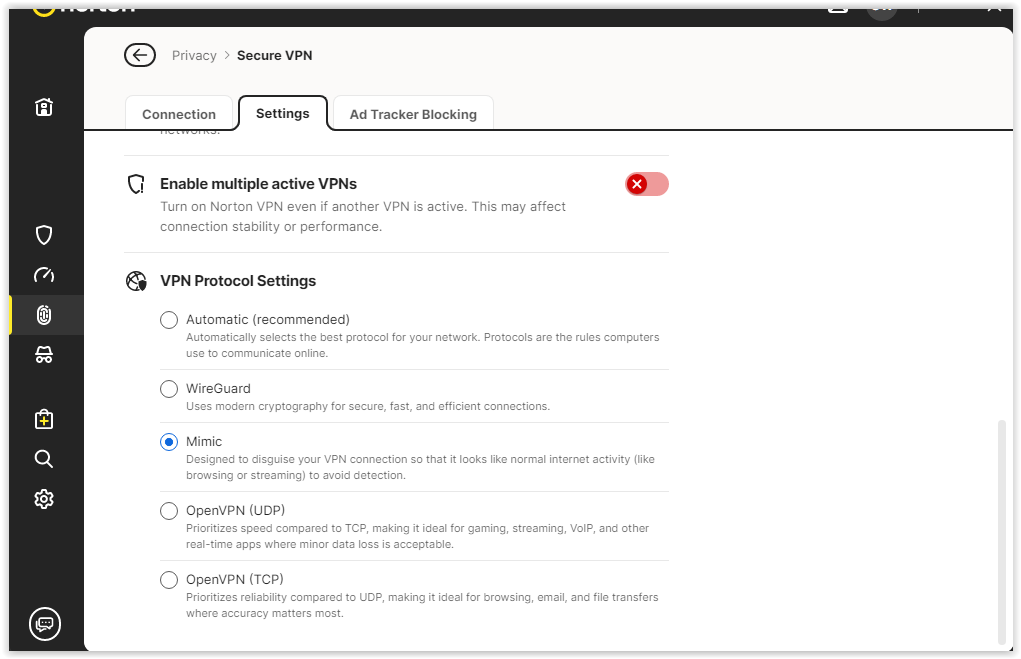

Here is the window with PreferredProtocol=mimic (same if I set it anything other than Auto).

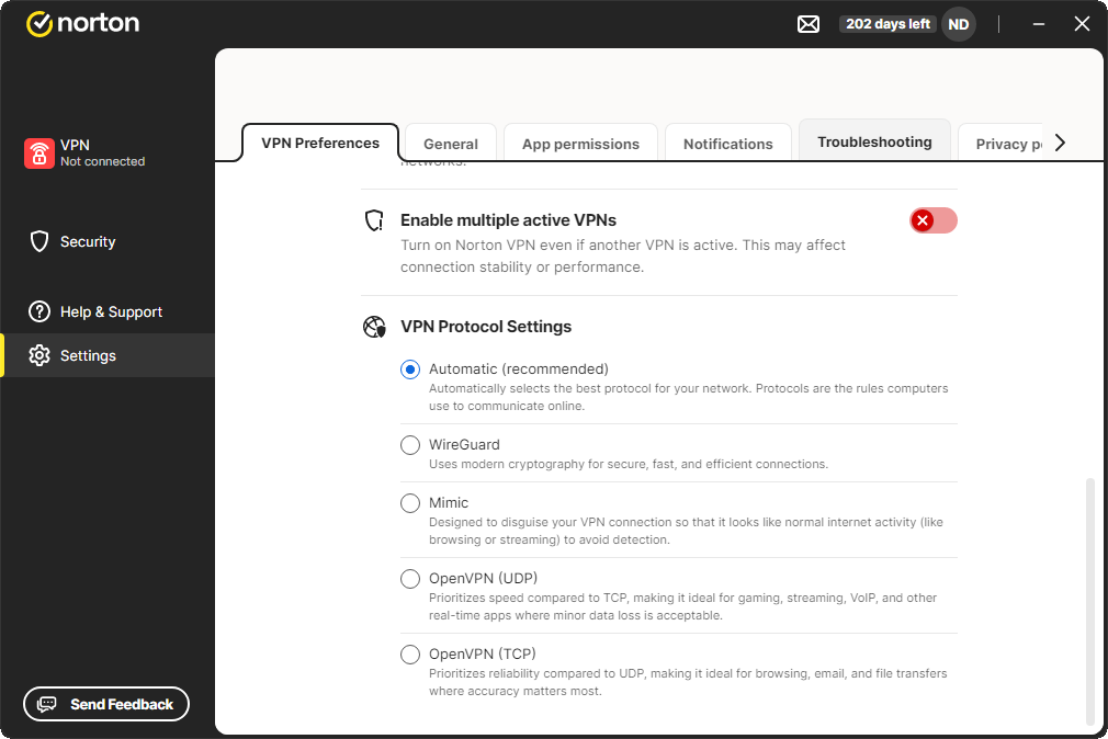

Here is what it is with the protocol set to auto
Norton 360 VPN has not yet received a protocol split into OpenVPN (UDP) and OpenVPN (TCP).

Norton 360 just updated yesterday and I now have the version that you referred to. If no PreferredProtocol key is in the ini file, there are no choices. The same if one puts PreferredProtocol=automatic. Only if you put the key …=mimic or anything other than auto, do the choices show. Also, if the choices show and you bullet auto, auto is then in the ini file and no choices appear afterwards. Since I now, if understood correctly, use wireguard, which you state is the default protocol used for auto, the choices stay. Before February 2025 , the choices always appeared but without the new split for OpenVPN. Perplexes me as to why they removed the choices when in auto. I understand most may not care or even know what to put in the ini file, but N360 has now taken that choice away. There must be some key that can make VPN in N360 display all the choices even if Auto is used. A key such as displaying the choices regardless of which protocol one uses.
