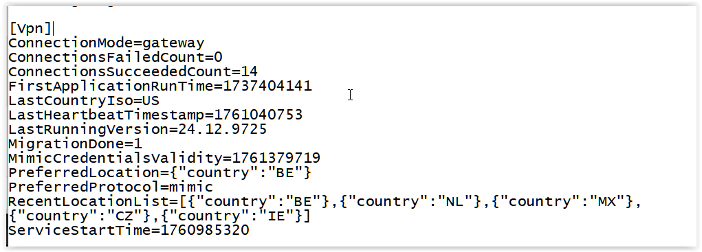

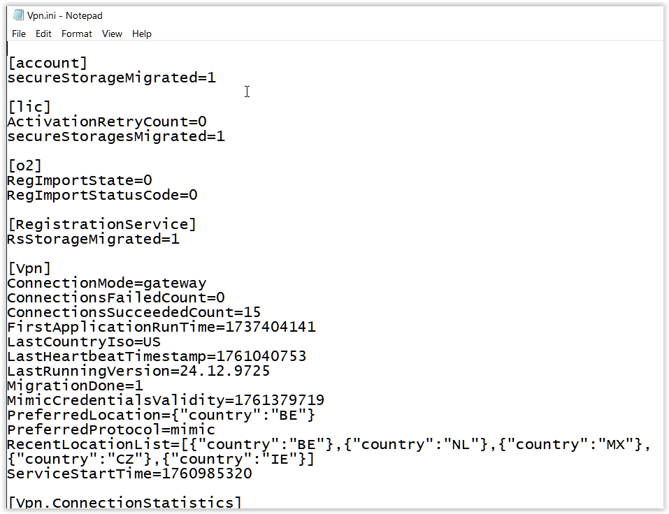

Copy the contents of your Vpn.ini or a screenshot so I can compare it with the contents of mine.
The whole vpn.ini or just a section? Like between [VPN] and ServicStart…
Preferably the whole thing, except for the very bottom one. It’s short there.
The only fundamental difference I see between mine and yours is the ConnectionMode=optimal. Yours is gateway.
Try changing your keys to ConnectionMode=optimal and PreferredProtocol=automatic.
Even with changing both keys, it the same…no choices. If I leave optimal and change auto to mimic, the choices are there.
I think I’m going to change optimal back to gateway and leave it at mimic or other protocol and not use Auto.
I don’t want to make too many adjustments and end up messing things up.

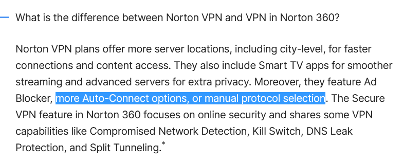

Interesting. I’ll keep using the N360VPN using the adjustments that I have for now and decide whether to pony up or go elsewhere for a different vpn.
Technical support can upgrade your Norton 360 subscription to Norton VPN.
