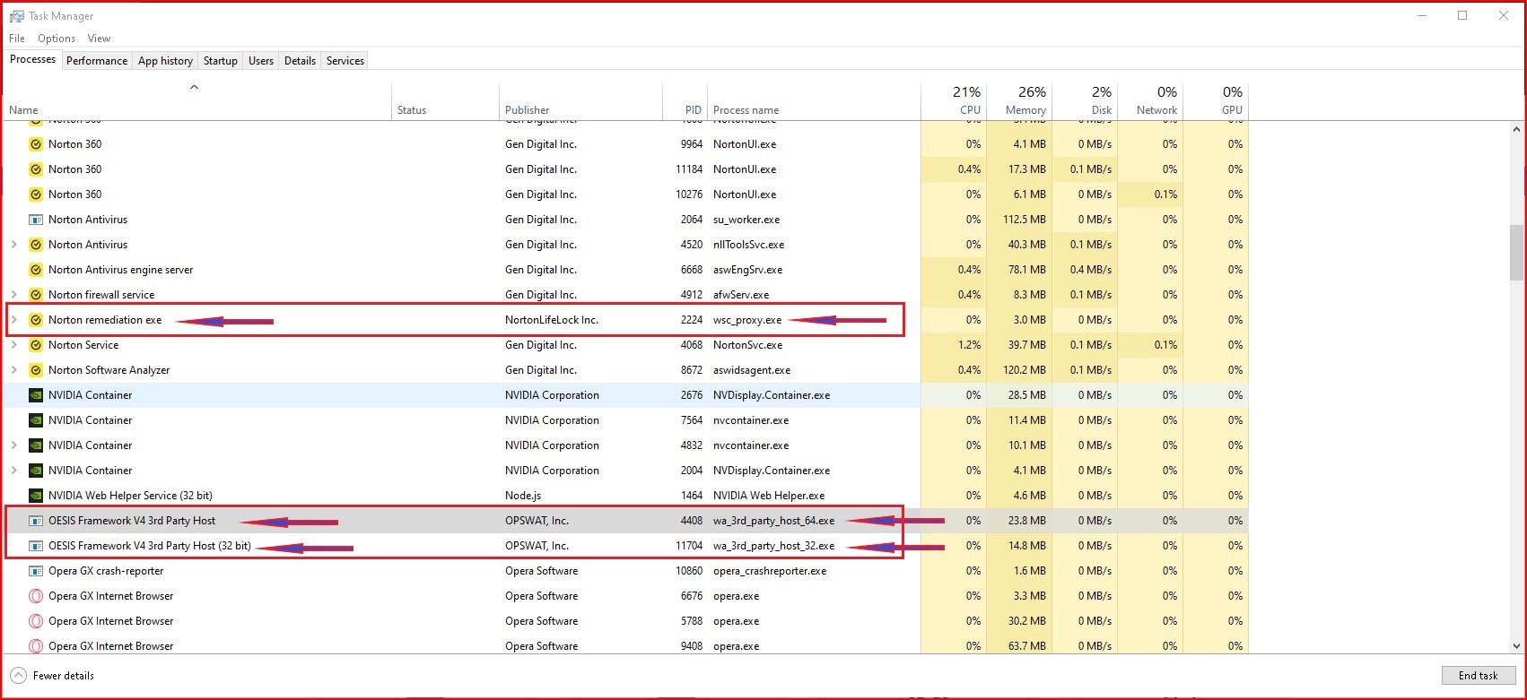

In my install of Norton 360 there are two files that I always change. To do so, you must disable tamper protection temporarily in Norton settings then find the two files shown in the screenshot below. They are located in this directory:
C:\Program Files\Norton\Suite
wa_third_party_host_64.exe
wa_third_party_host_32.exe
I renamed both files, one I set to the name 32.exe and the other 64.exe. Then, set the file properties to “read only”, saved, then rebooted. This scenario allows me not to see nearly all the sell-ups that can drive us bonkers as well as steal focus while using our devices. I also DO NOT run Smart Scans for any reason.
These files are tied to scanning for software updates and other updates. Tied to OPSWAT Meta Defender services.

These DO NOT appear other than at random times and DO NOT run resident with Norton. The process wsc_proxy.exe DOES!! I have found they ARE tied to certain background services for scanning and data gathering about what is and isn’t installed. These files renaming has allowed me to not see most nags over a long period of time. Your mileage may vary of course!!
PLEASE NOTE: Performing this suggestion should that be your course of action is done at YOUR PERSONAL RISK. Make sure you are confident in what you are doing beforehand.
