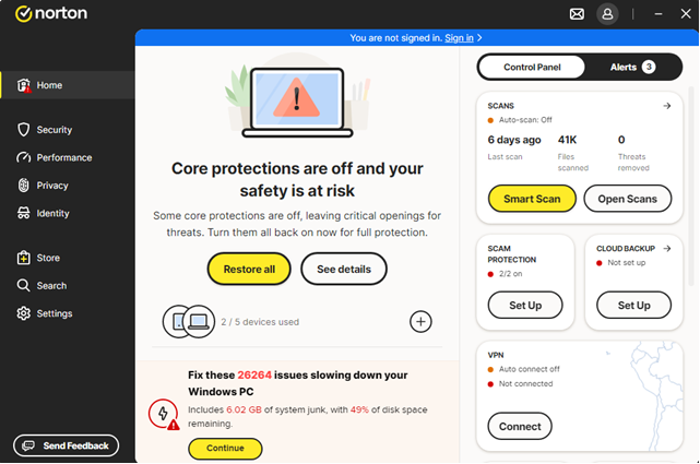

Core protection are off and your safety is at risk
Helping my neighbor who also uses the Norton 360 product. See windows snapshot below. What causes this Norton screen to appear?
Norton product & version number: Version: 25.10.10528
OS details: Windows 11 (version: 25H2 26200.7171)
See screen shot below to see what the Norton windows they are getting.
I am relunctant to have them click “Restore All” until I better understand why they are geting this Norton window displayed.

@Parryjm I would do a simple restart of the computer, then run live updates with Norton to see if that changes things. Windows Core Isolation settings won’t affect Norton, Norton will affect core isolation if there is a corrupted update delivered.
SA.
Checked Core islolation and the setting were…
Memory integrity was set to "Off"
Location Security Authority protection was set to "ON"
Microsoft Vulnerability Drive Blocklist was set to "On"
These were the same setting as on my computer.
I tried turning Memory integrity to "On", but it would not allow me to turn on.
When I clicked on "See Details" it said to restart computer to install important protection updates
I restarted laptop, looks like issue got resolved.  No longer saw the "Core Protection" screen.
Things are back to normal.  Thanks for everyone's help :-).
