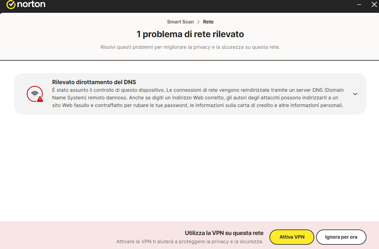

I am contacting support because Norton 360 repeatedly reports that “This network is compromised – DNS traffic has been redirected to a malicious server.” when I run the Norton Smart Scan.
However, after performing several technical checks, I have not found any evidence of DNS hijacking or network compromise. I would like to report the behavior because it may be a false positive generated by Norton.

However, Norton Smart Scan still reports that the network is compromised and DNS traffic has been redirected to a malicious server.
The only time the warning does not appear is when I run Smart Scan with Wi-Fi disabled. As soon as Wi-Fi is enabled and I run the scan again, the warning appears.

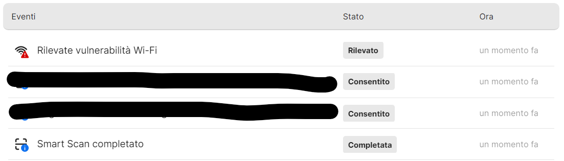

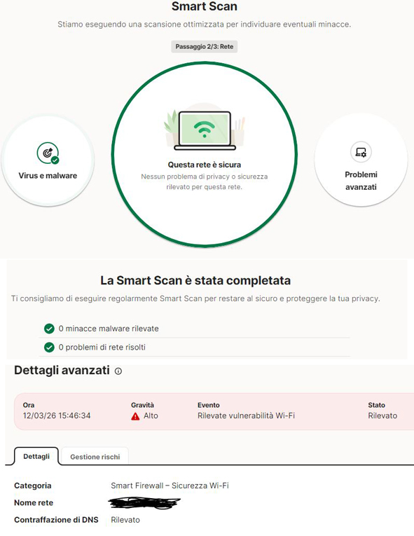

Thank you for the valuable help. It seems resolved, but if you look at the attached screenshots, DNS hijacking is still detected in the security event report
NB: The same problem is present on 2 different computers
Depending on your location, it can take time for the update to get distributed to all the update servers around the world. Just keep trying over the rest of today.
Yes, that’s true. I checked as well now. The Smart Scan doesn’t detect anything, but in the Security History it still shows ‘Wi-Fi vulnerabilities detected.
Does the time showing for the detection match the time of your last Smart Scan? You could just be seeing the previous detection.
Yes. After running the Smart Scan, in the Security History it shows “Wi-Fi vulnerabilities detected” with the time “a moment ago.”
