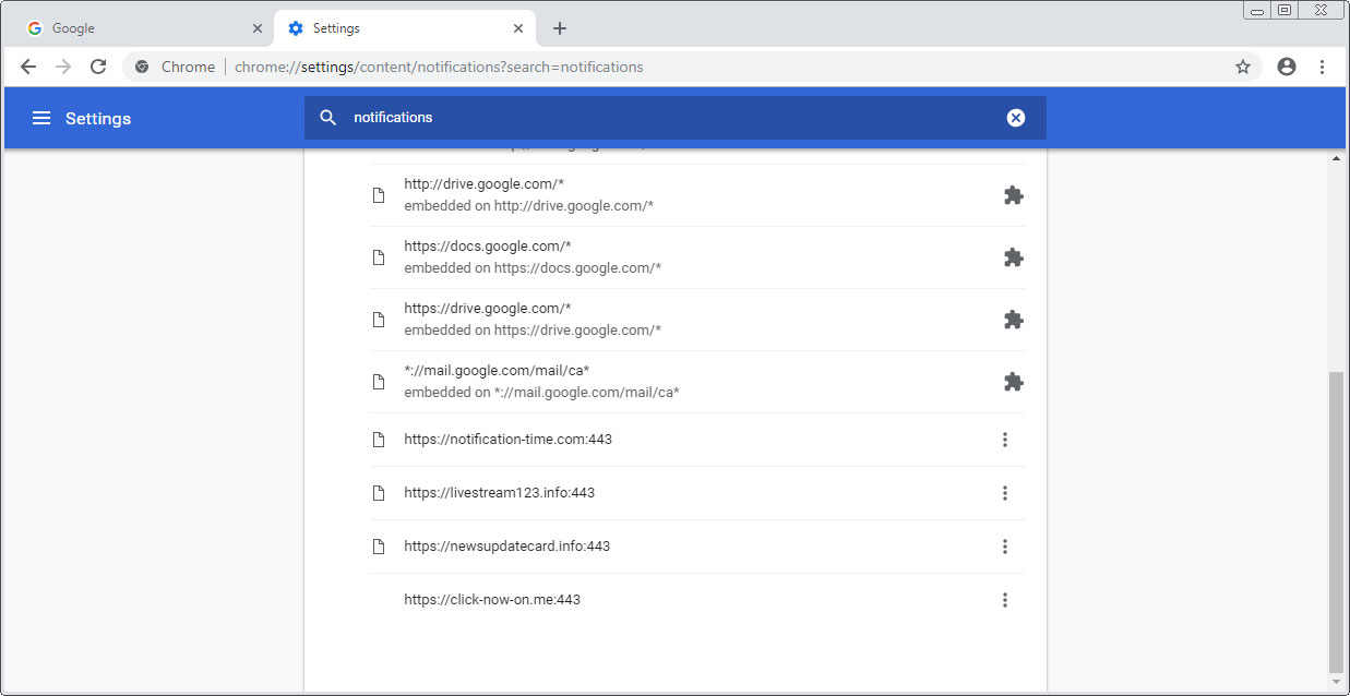

If you are receiving browser notification spam, you can check for and remove subscriptions by going into your browser's settings.
To remove them in Chrome, you can go into the Settings and search for Notifications, click on Content Settings, and then click on Notifications. Chrome will now display a list of sites that you are subscribed to or have blocked.
Subscribed Sites in Chrome
To remove a notification, simply click on the dotted vertical line next to a site and select Remove as shown below.
