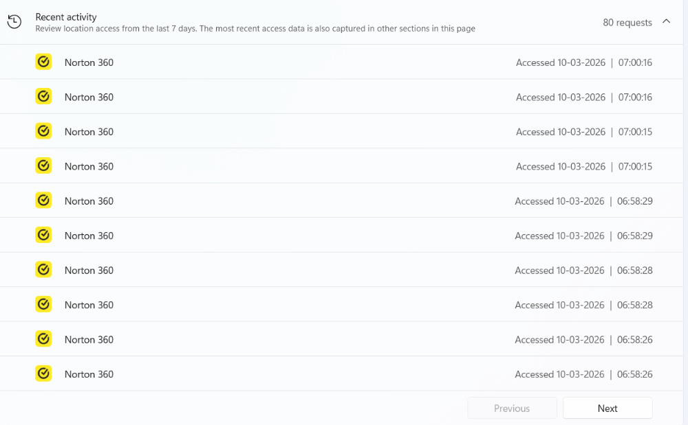

I would like to report what appears to be abnormal behavior with the latest version of Norton 360 on Windows (26.2).
Issue Description
My Windows system reports that Norton 360 requested location access 80 times within a 30-minute period.
This frequency is extremely unusual and raises two concerns:
  • Privacy concern due to excessive location access requests.
  • Battery drain and performance impact on my laptop caused by constant background activity.
A security product should not need to request location data nearly every minute, so this behavior appears to be a software bug or malfunction.

I have attached a screenshot of the Windows activity log showing the location requests.

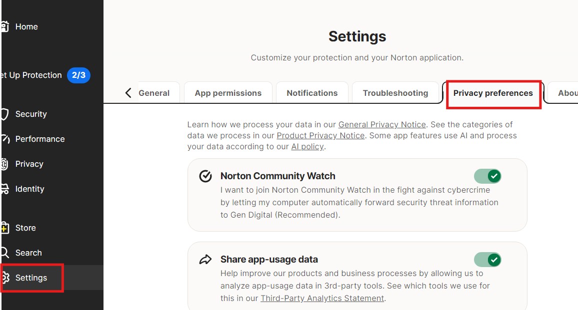

Not sure if this would have anything to do with what you are seeing, but check your 360 Settings > Privacy preferences tab. If you have both options turned on there, try turning them off. Then restart your computer and test. Restart, not shutdown and startup again.
I followed your instruction and disabled those option and Yes I restarted (not shutdown) after restart still the same issue.

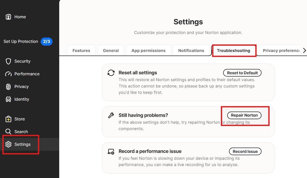

Let’s try going into 360 main interface and click on Settings > Troubleshooting tab. Then click on Repair Norton and see what it finds. Then restart your computer and test again.
To resolve this issue I have freshly install windows 11 (25H2) twice and freshly install norton so do you think this option you are suggesting necessary ?

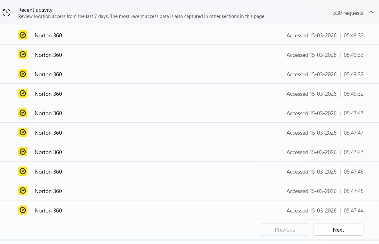

I took this screenshot from Windows 11→Settings→Privacy & Security → Location→Recent Activity
I checked this because there was a constant location request in System Tray when Laptop was booted for few minutes.
I have this issue on Multiple Laptop (1 thinkpad, 2 Latitude)

I am using Windows 11 version 25H2 (build 26200.8037). Two devices has Microsoft account and one local account, and all laptop experience the same issue. Location services are enabled for both Windows and desktop apps on all devices.
I followed your suggestion: I disabled Wi-Fi, waited for about 3 minutes, restarted the laptop, and then waited another 10 minutes. During that time, Norton did not attempt to access the location service even once.
However, as soon as I enabled Wi-Fi again, Norton immediately started repeatedly accessing the location service, causing what looks like a continuous bombardment of location service requests.
