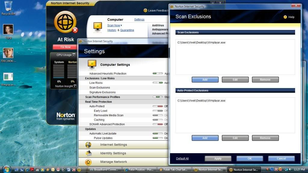

delphinium wrote:
You should be able to open Norton's main screen, go to computer settings and scroll down to where you will find "Scan exclusions."  Click on configure and add the files to both auto-protect and scan exclusions.  Only if you are sure it is a false positive!

If you 100% sure that this file is not threat..and than follow my way to get this thing resolved..see this picture keenly and than do..
first turn off auto protect than follow these setting parameters...and your file will not picked as trojan or something..!!
And do not forget to turn on your protection that is auto protect of Norton after doing all these things..

Thanks to everyone for the quick response. I was able to reinstall the files and add the exclusions (thanks to delphinium for showing me how to do that). After re-enabling Auto-Protect, everything seemed fine. However, after a couple of hours I came back to a message from Norton telling me that once again it had protected me from a trojan horse and had removed the files, despite the fact they were added in the exclusions list.
Fortunately, I did a little digging and found the other file application that will still allow me to launch the PortableApps menu. I guess it's better to be protected against nothing than to not be protected at all. It's pretty annoying at times, though. Kind of like an overprotective mother.
