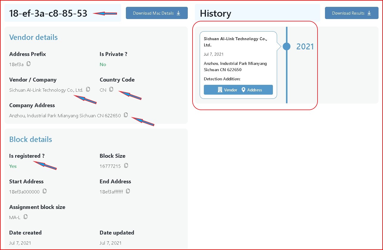

The second one, is the reason for this post. It is a stern warning to TP-Link device owners, even if your router is current with its firmware and no identified CVE’s are outstanding and unpatched. I found the following MAC address listed with an IP address that was NOT listed in my routing tables, not logged in the router. Below is where that was ultimately traced:
MAC address: 18-EF-3A-C8-85-53
You can decode a MAC address using this free service online: Here are my results.
Note: These devices are manufactured in China and have been the subject of national security issue over the past 2-3 years here in the USA.
https://dnschecker.org/mac-lookup.php?query=18-EF-3A-C8-85-53
*** What I know: This router, a BE550 is currently supported and its firmware IS the most recent available. There are NO settings enabled in the router that would indicate the use of AI, no VPN, no QOS enabled, no offered security side software enabled. I have this MAC address blocked at the router level, to date it has NOT reappeared. I have reset this router and conducted a 32 character password for the admin login and each network that is active.

That’s a good catch, but do you mean you recently blocked the MAC address 18-EF-3A-C8-85-53 (Sichuan AI-Link Technology, China)? I’m just wondering if this could prevent future firmware / security updates from being delivered to your TP-Link Archer BE550 router.
Sorry for the tardy reply. YES Maam. I indeed have blocked that MAC address on the router. It has attempted to reappear once but gets auto-blocked. I can indeed check for firmware updates as normal with this blocked. Conversely, I have filed a complaint with CISA giving them the information posted above for review.

Sichuan AI-Link Technology is a massive manufacturer of Wi-Fi and Bluetooth chips used inside everyday smart home devices. If this name appears on your router’s device list, it is almost certainly a harmless gadget in your home, not a hacker. [1, 2, 3]
Common Devices from AI-Link:
  • Robot vacuums
  • Smart plugs, lights, and switches
  • Air conditioners, humidifiers, and air purifiers
  • Smart TVs, media boxes, and streaming sticks
  • Smart scales and medical instruments [1, 2, 3, 4]
How to find out exactly what it is:
  1. Change your Wi-Fi password in your router’s admin panel (learn how using tools like Fing’s Wi-Fi Guide).
  2. Restart your router.
  3. Reconnect your known devices one by one.
  4. The unidentified AI-Link device will remain disconnected, prompting you to see which smart appliance in your home is no longer responding
