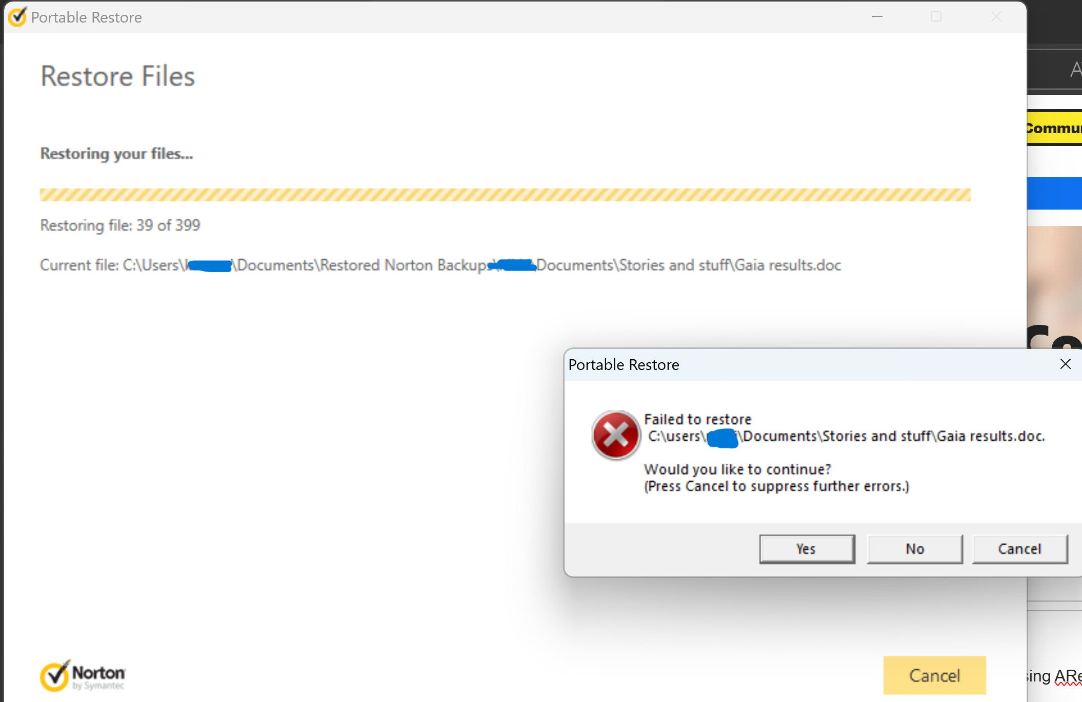

Using ARestore it detects the backups and gives the option to restore, but trying to do this to a new folder stops with an error for every single file stating “Failed to restore”. See image attached.

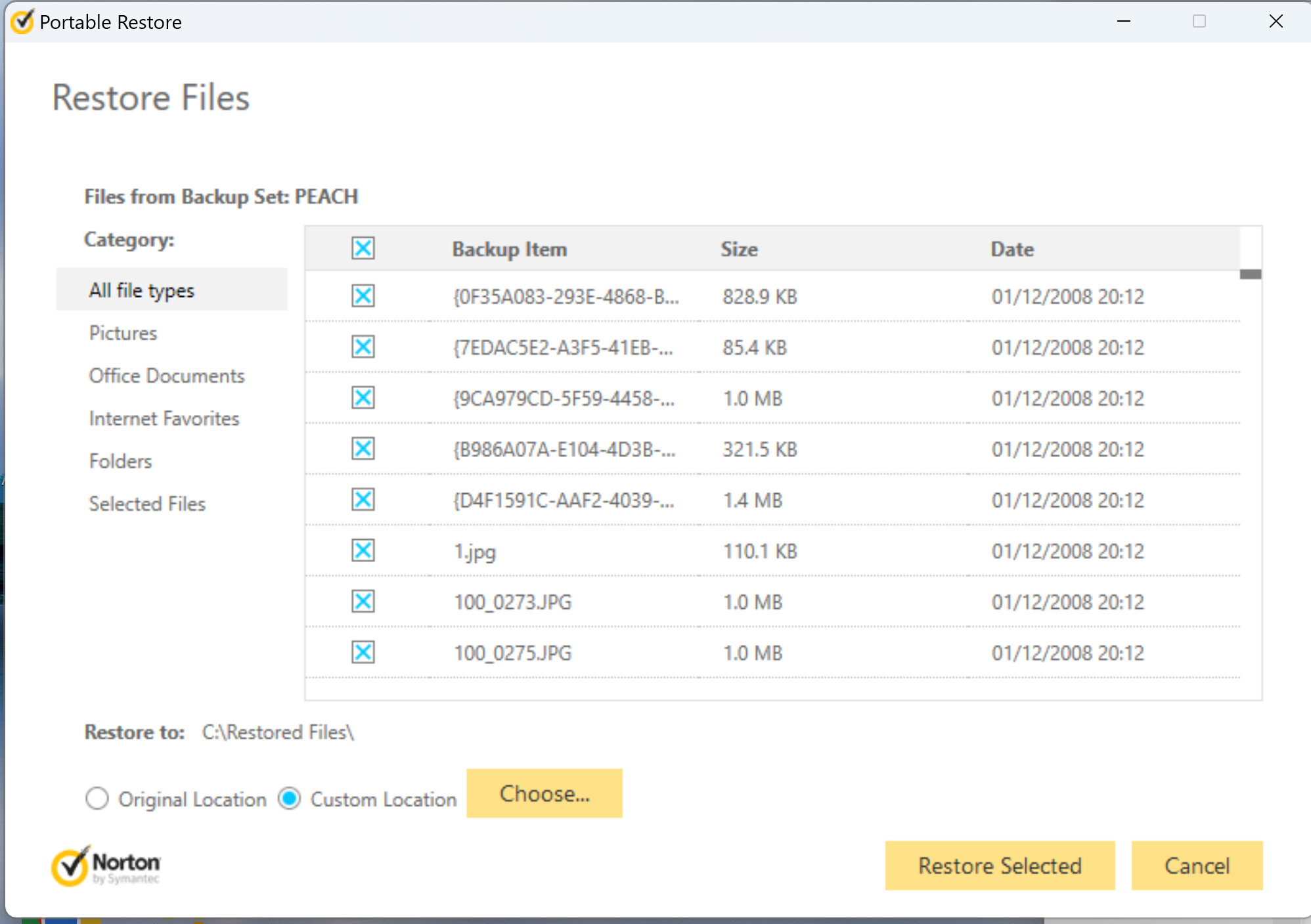

Edited: Is there an option to restore to a destination/folder./directory other than the original? Just a though.

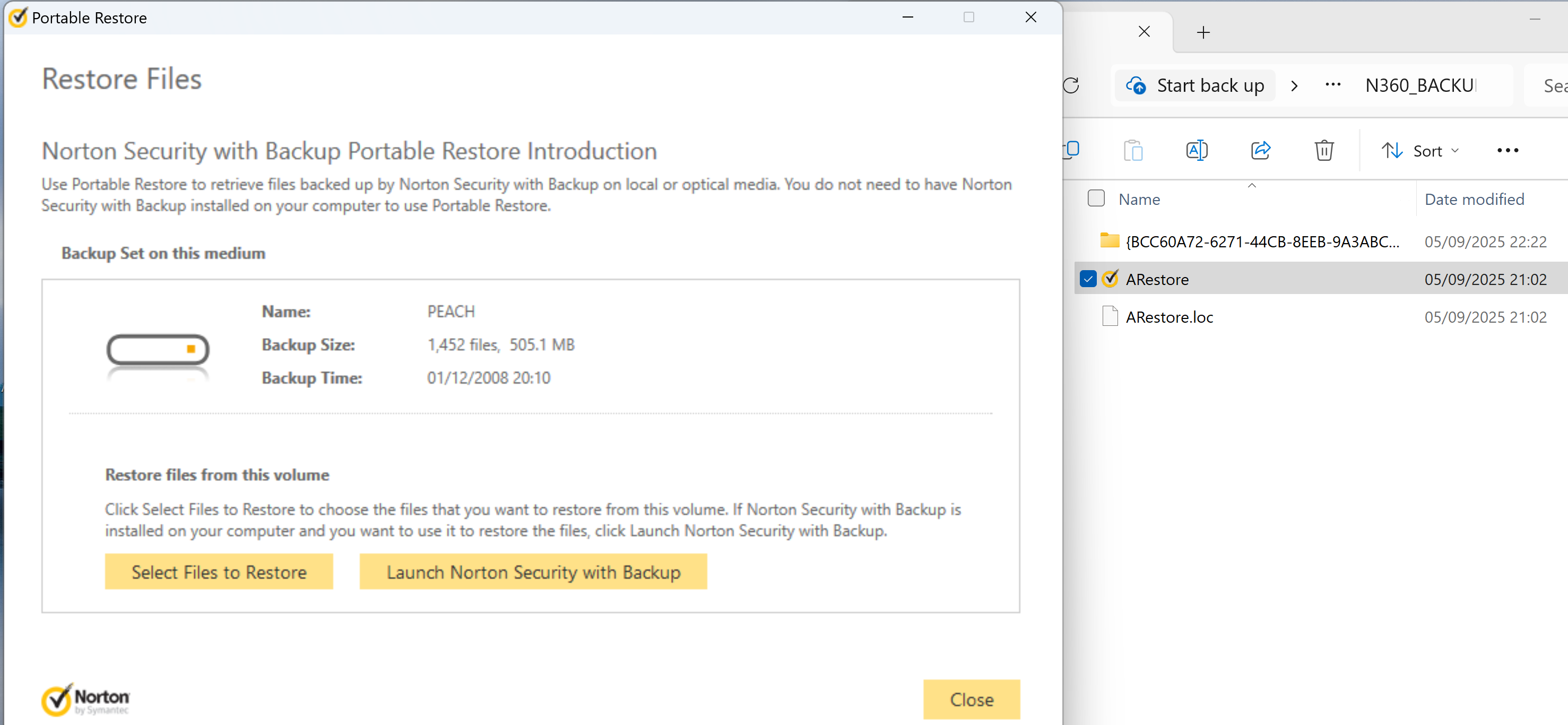

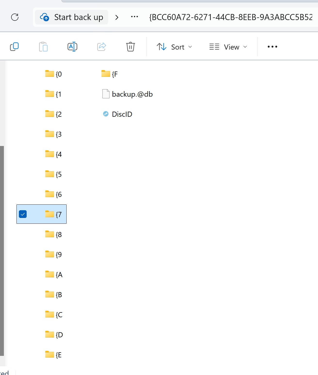

Neither Arestore or the .loc file were present within the CD backups themselves, they only have a backup.@db file inside the N360_BACKUP folder. So I went looking for the program and downloaded it.
I have been pasting the program and .loc file into the backup folder to restore.

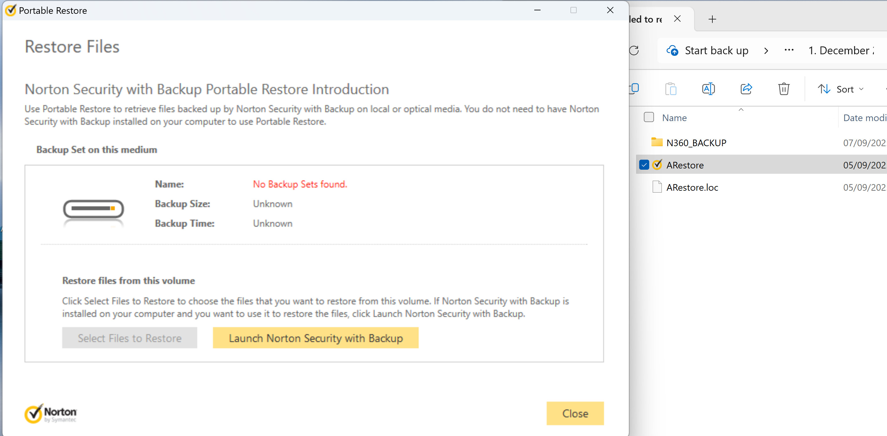

I took screenshots of the steps I took, I can only post one per comment so hold on..
Restore failing on a different backup set from a second disc.

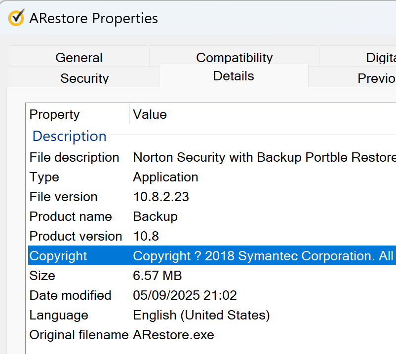

Which version ARestore is? …It’s not version 25 lol
It would have to be somewhere in here otherwise no, it doesn’t appear to have a copy of ARestore inside the backups.
So it appears you did get the first, Peach, backup to restore. Did you copy the CD contents to your hard drive in a temporary folder and then add the Arestore.exe to that folder?
Then the second CD did not restore. Did you do exactly the same thing in adding the Arestore to that backup set?

So, Peach was the name of my PC back then. None of the backups work. Pasting the ARestore program into their folder allows it to see the backups. It gives the option to restore them. But then it fails every time.
Is it that I need the original ARestore that seemingly didn’t copy with the backups, from the version of Norton, or is there anything else I can do to restore these? I doubt, if I need a specific version of the restore program, that I’d be able to find that exact one 16/17 years later… Wow.
