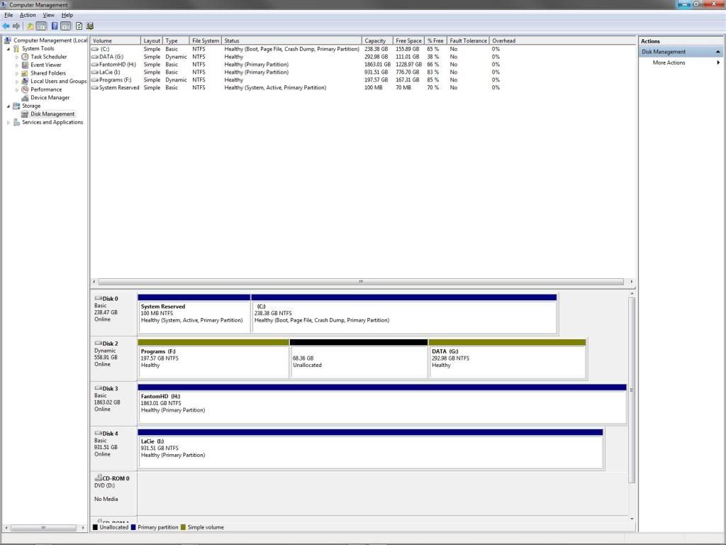

Can you post a screenshot of Disk Management here and on Photobucket etc?

I intend to do that.  When you asked what type of drives, etc that crossed my mind.  Unfortunately, when you can see the computer management screen that I've attached in pdf, drive #1 which was my new SSD target drive seems to have disappeared after my attempted copy.  This just gets worse and worse.
I was not familiar with photobucket, but I registered and I think this link should work to see the picture: http://i1336.photobucket.com/albums/o659/aztec506/CompMgmt_zpscc9893b2.jpg
If not, I've attached a pdf

Edit.... Just saw your attachments. Is Disk 2 really Dynamic? Can you see the SSD in the BIOS?
Brian that pdf shows it.
disk 1 is the new SSD that is not being shown in disk management.

diskpart/disk list does not show drive #1 which disappeared.  It was there and has been there for two weeks as unallocated space with no drive letter until today when i started trying to do the imaging work.

I have no idea what GPT disks are?  disk 1 should be the new SSD that is not showing up in comp mgmt.  This is this disk that I was targetting with my image, but ghost couldn't see it.  Ghost did see it when I attempted to copy my f drive to it running in windows, but has disappeared after that in computer mgmt.
Disk two has two partitions: F:\ Programs (which I had made the image from to apply to disk#1) and G:\Data which holds all of my data, pictures, etc.  I had intended to wipe F off of this after the image was transferred to disk one which was to have been my new F:\ and expand the G partition to the whole drive.   It is a WD Raptor 600gb that windows 7 says is a "dynamic disk"  How it got that way I don't know, but Acronis doesn't work with dynamic disks according to it's manual and when I attempted to image that disk it was grayedd out in Acronis.
