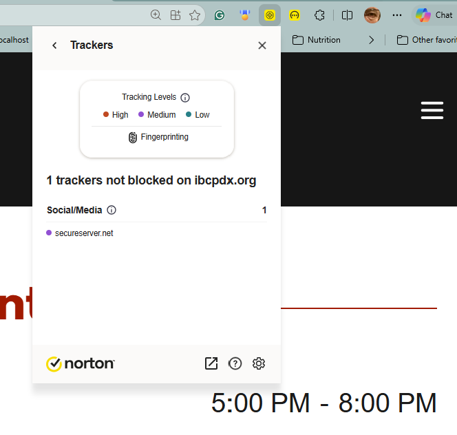

GoDaddy Webbuilder_Marketing websites misbehaves on Windows - The “cause” was AntiTrack (AT) excluding two trackers: “secureserverdotnet” and “wsimgdotcom”. The Calendar sections of the website displayed correct times after turning off AT. This screenshot seems to indicate that the culprit was “ws.imgdotcom”.

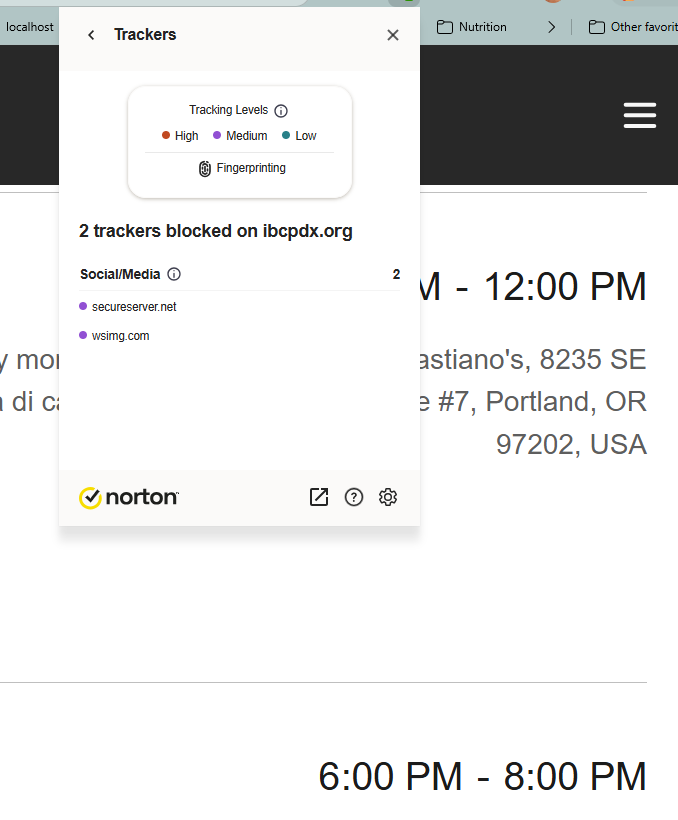

The screenshot with the bad times was:

This new screenshot shows exactly what went wrong.
When the calendar displayed the incorrect times, Norton AntiTrack was actively blocking both secureserver.net and wsimg.com .
Your deduction is spot on. While secureserver.net manages data communication, GoDaddy uses wsimg.com (GoDaddy’s static web assets domain) to deliver the critical JavaScript code that renders and calculates elements on the page—including localized time zone shifts for the calendar widget.
When Norton blocked wsimg.com, the script responsible for adjusting the event times to the local time zone couldn’t load, resulting in the “bad times” visible in the background.
