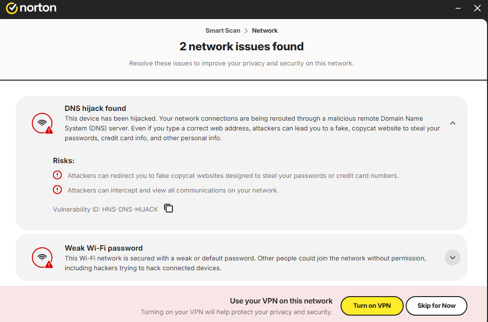

HNS-DNS-HIJACK and HNS-WEAK-WIFI-PASSWORD
Issue abstract:
Detailed description:
Product & version number:
OS details:
@Ashish_Jain Hello. Running a Smart Scan generally always results in issues that are not present. The fix is most times a sell-up to correct the issues reported. Given this is a wifi issue, here is my best advice going forward:

IF, you have not had any prior notifications that may suggest an infection, your internet speeds suddenly dropped for no reason the above suggestions are the first steps. Conversely here are a few things you can do right now:
  • IF you are using the factory default logins and passwords, immediately change those. IF, you cannot log into your router FACTORY RESET IT and start from scratch.
    - IF you have never set unique WiFi passwords and they are still factory defaults also change these.
