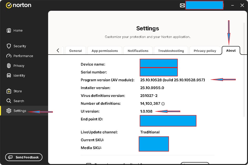

What is your OS and its version? What is the Norton product you have install and its version/build? Have you checked these settings in Norton?

Here is where to find your installed Norton version and build within the Norton UI:

UI 1.0.108
Program version: 25.10.10528 Build 25.10.10528.957
