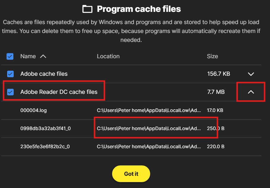

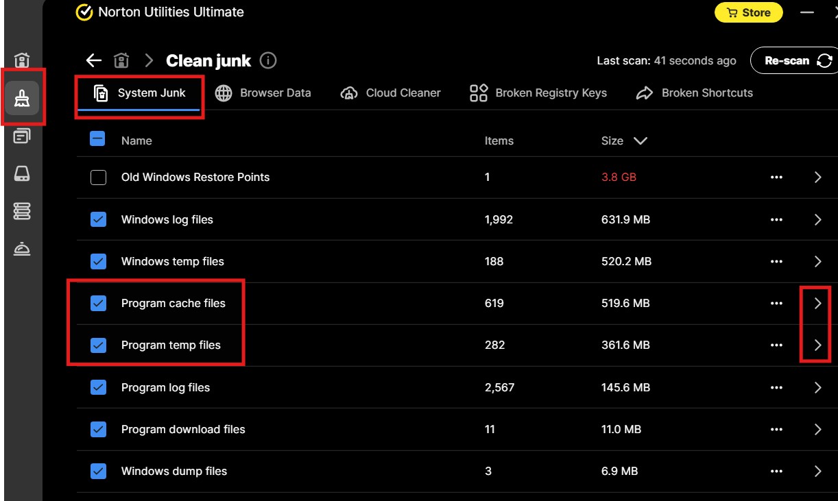

From the Norton Utilities Ultimate, NUU, screen click on the Clean Junk icon on the left, then in the System Junk tab scroll down to the Program cache files and Program temp files. Check each of those by clicking on the right arrow on the right side. Then scroll down the list of cache files until you find ones for your scanner. If you find it, click the blue box beside that to remove the checkmark. Clicking Got it at the bottom will now no longer clean those files.
