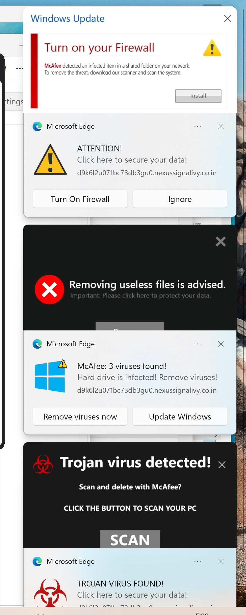

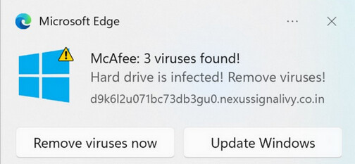

How to solve the virus on windows 11 fake alerts always shown
Issue abstract:
Detailed description: Continuously endlessly pop-up alerts from Windows 11 notification function.
Product & version number: Norton 360 Premium
OS details: Windows 11 Pro Version
What is the error message you are seeing? Continuously endlessly pop-up alerts from Windows 11 notification function.
If you have any supporting screenshots, please add them
