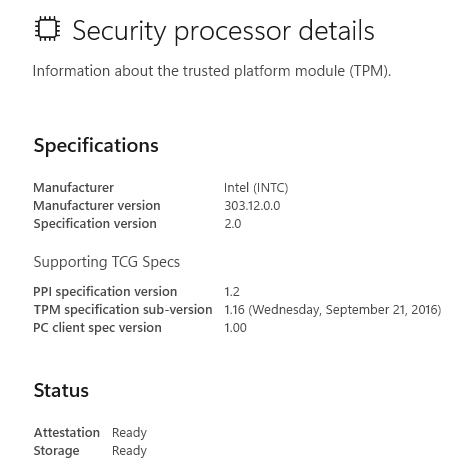

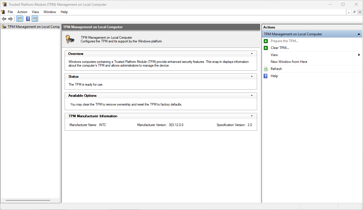

Re TPM.
and
I don’t think TPM was my problem. I think it was the number of cores.
