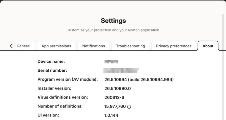

I can’t find the version number in my settings, but I’m on the most current version of Norton 360 Premier. I also have Malwarebytes installed on my Windows 11 desktop (updates are all current). Last week Norton detected a file on my computer and asked if I wanted to continue to block it. Since it was asking ‘conitinue to block’ I thought it must need to be blocked, so I said yes. The blocked file was DDSHelper.exe which I later found out is a safe file from Malwarebytes app. I have had nothing but issues logging in to a variety of web apps ever since - Shopify, Amazon, Costco, an HR program I use for work, Adobe, etc. I would like to remove the block on the file but don’t know how to and can’t find a support number for Norton in Canada. I thought perhaps I should just uninstall Norton and then reinstall but not sure if that would solve my problem. Can anyone shed any light on this, I’m afraid the tech stuff is not my forte and it’s making it super difficult to do my work without access to these apps. Note that I am still able to access the sites on my Windows laptop and my ipad without any issues. I would appreciate a number that I can call tech support so they can guide me through this.
Settings → About

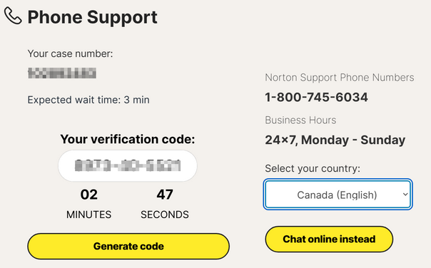

Official Norton Support – United States & Canada – 800-745-6061 | 800-745-6034
Norton Support Help Center Contact us (bottom of page)
Contact Norton Support Let’s get started.
