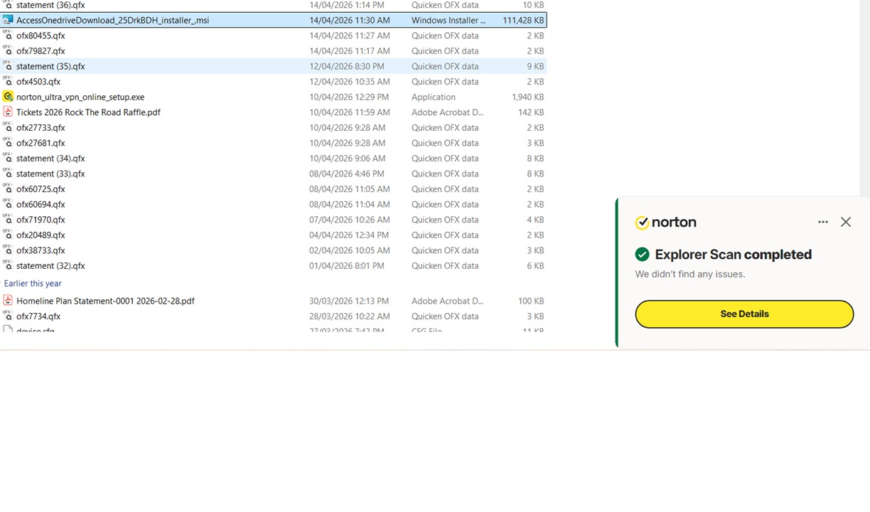

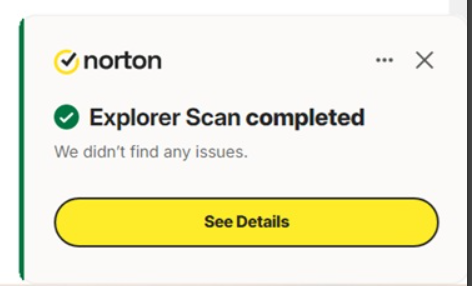

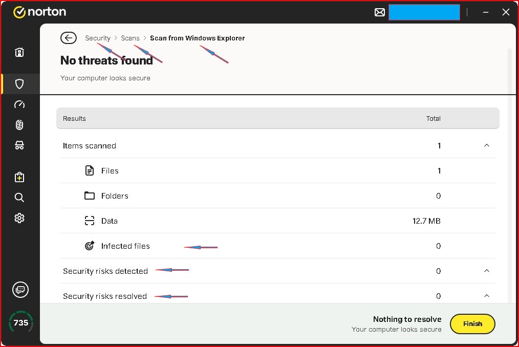

On my Windws 10 Pro daily duster machine, I get the menu to select and scan a file, doing so a notice popup appears in the lower right corner of the desktop. I then click the large yellow banner stating “See Details” which opens to scan details. The scan results are shown there.

@peterweb I see the same. When clicking the See Details radio button I get the extended results as in the screenshot posted earlier. This is the ONLY indication I get that a scan was done and takes user action to get the results output.

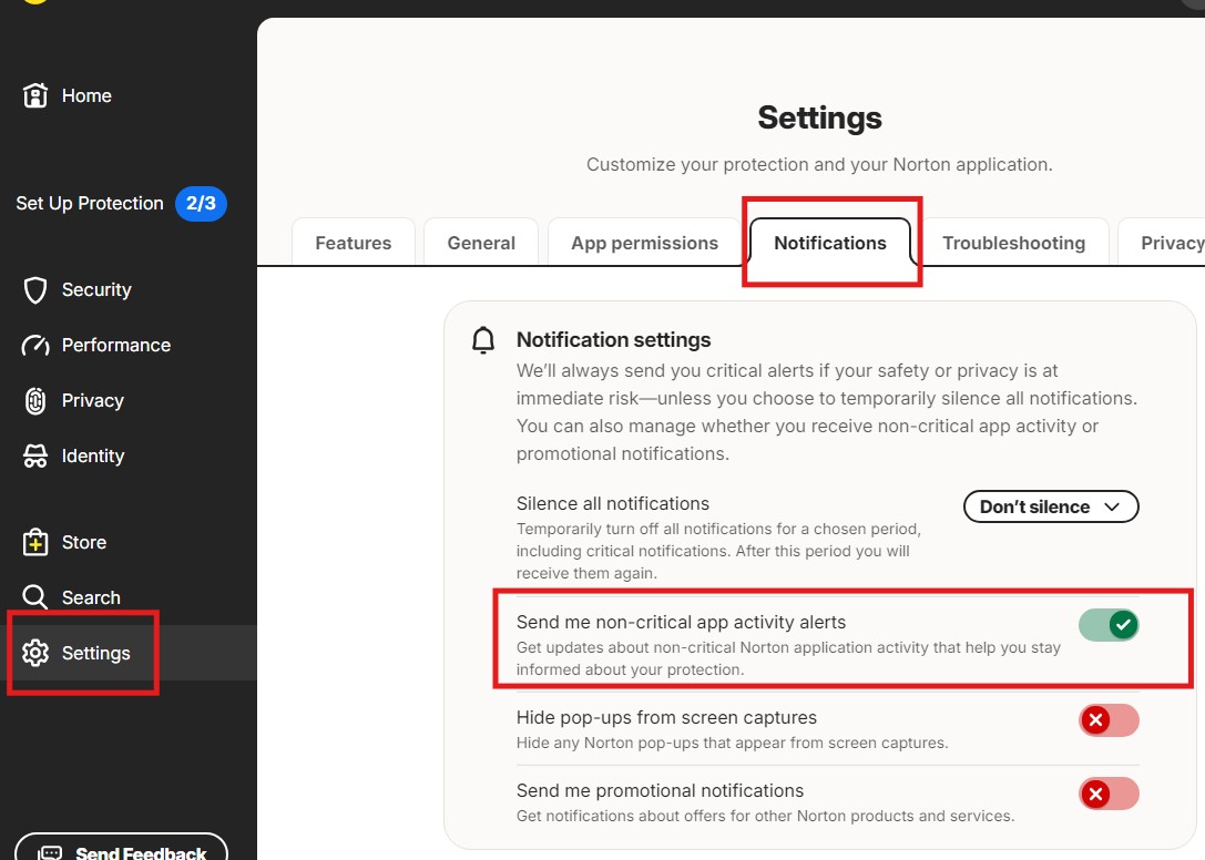

Check your 360 Settings > Notifications tab and turn on the Send me non-critical app activity alerts, and test to see if you see the Scan completed popup.
Thank you. This issue has been resolved.
