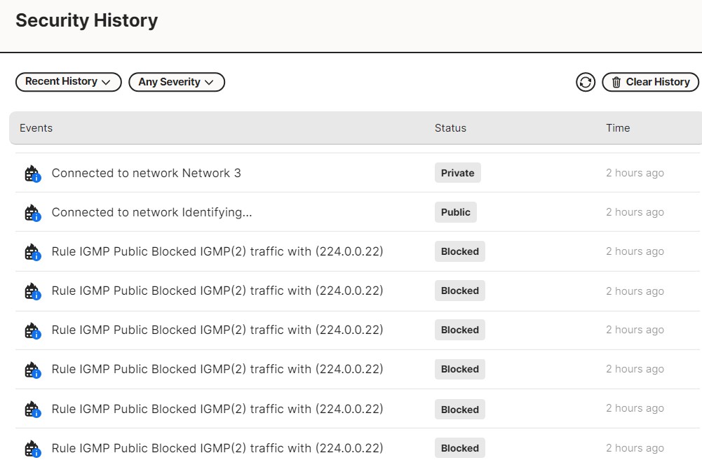

Lately, Norton’s 360 V25.5 Smart Firewall has been logging constant “IGMP Public Blocked 224.0.0.22 (2) etc” in Security History, even though nothing seems broken or slow on my end. I didn’t change any network settings, and this just appeared out of nowhere.I’ve seen others mention similar logs tied to multicast traffic—could this be a harmless system/service behavior Norton is flagging a little too aggressively?

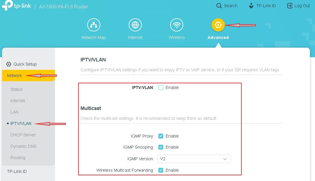

Before I start looking around these are my settings on my TP-Link personal router, its setup as yours is. Wifi is disabled on the Verizon G3100 combo device and I use Ethernet plus Wifi on my router. These are the settings for IGMP in my personal router. I have NOT touched the IGMP settings in the Verizon side since I basically allow data through it and filter down stream via TP-link settings. You may want to have a look at your router settings as well. Typically these settings stay at the defaults to ensure gaming and streaming don’t overload the network for any one given device: Note- I do not have IPTV/VLAN enabled but DO have settings enabled for Multicast. VLAN tagging is better used within and designed for a business / corporate environment.

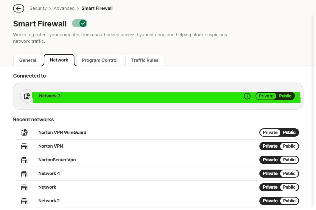

Check for Norton having changed your connection to public as it is showing that in your screenshot. Change it to private and re-start. Lets see if Norton changes it back to public again and those entries do fresh logging. If that happens Norton is the issue with your network security on ethernet. Make sure that in Windows settings your network type is set there as private as well.
@SoulAsylum – Yes, both my wife and I run Windows 10 desktops. We are both hard-wired (Ethernet) into the same gateway. She has been appointed to Network 5, I’m on Network 3. I don’t know anything about this, as our computers are totally independent of each other and our wi-fi is off at the gateway. She doesn’t see this in her history. I checked gateway, Windows settings, and my Norton firewall says #3 is private. See below. This usually has started have I come out of sleep mode or boot up. I’m wondering if it’s some program I have. Also I’m surprise her network 5 is not listed under recent.
