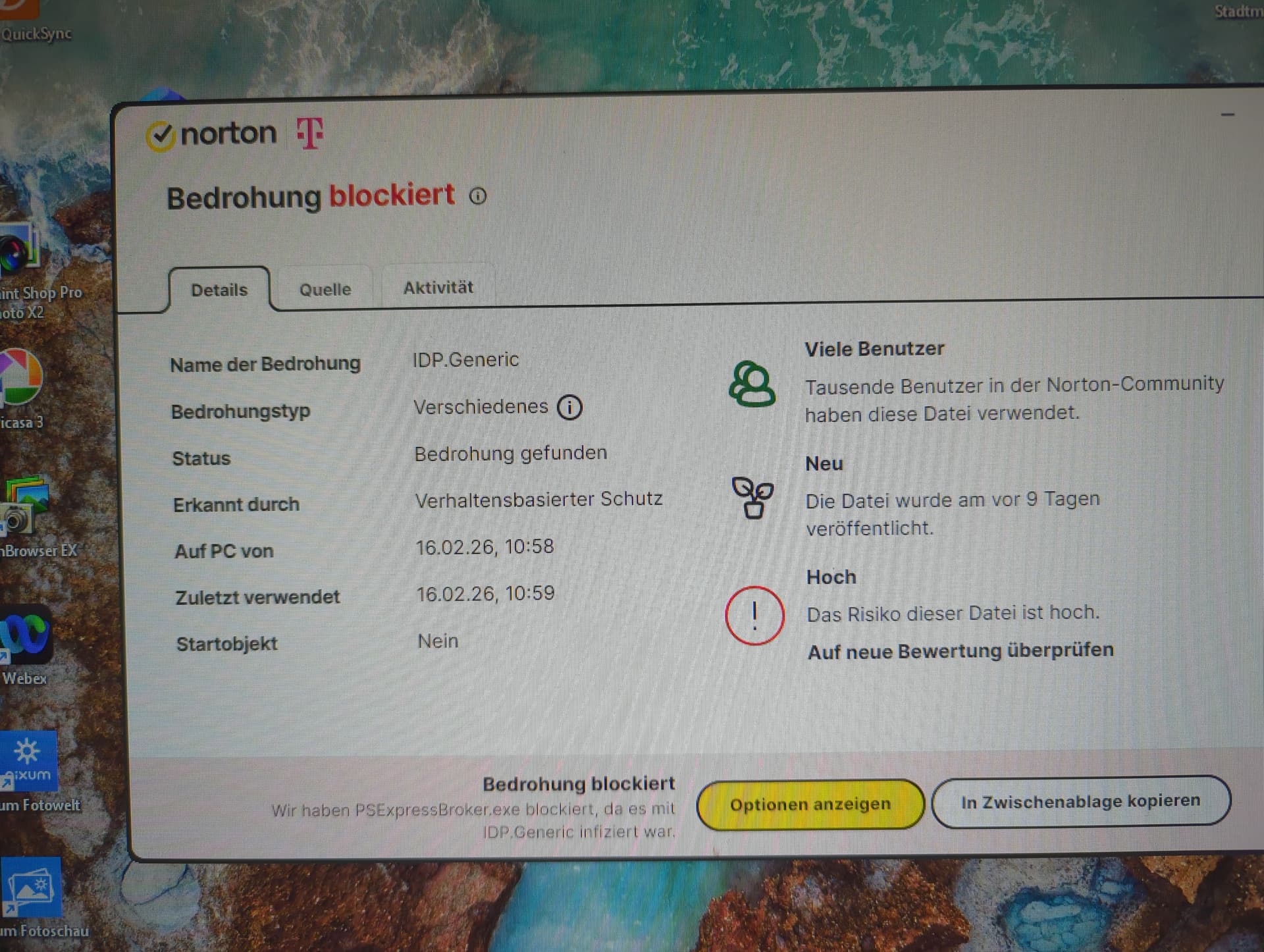

Genau dasselbe Problem habe ich auch. Konntest du herausfinden, wie man mit der Meldung umgeht?
Norton hat die Bedrohung blockiert und in die Quarantäne verschoben.
Adobe Express Fotos öffnet sich nicht mehr.

OVERREACH by Norton. Out of the blue Norton just moved the entire exe file to quarantine. Should I delete it from Q or extract it from Q and otherwise do I have to reinstall.
I downloaded Adobe Express Photos directly from Adobe. Uninstalled and downloaded/reinstalled a couple of times. Each time the program worked for a few days, then Norton flagged and quarantined PBExpressBroker.exe. The app seemed useful, but I gave up and use other free, browser apps like PIXLR. Although AEP had some useful features, Norton prevents me from using it. Note the name change – Adobe Photoshop Express was rebranded Adobe Express Photos. Maybe try again soon to download and install – perhaps the problem has been resolved.
