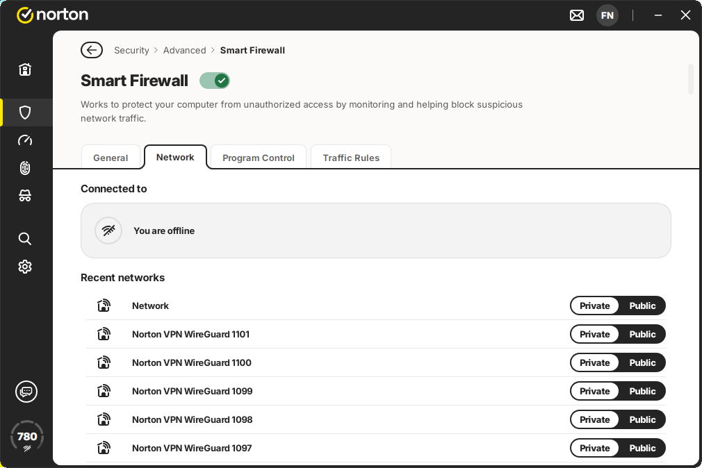

The information I was referring to is ‘hidden’ away in Windows Registry:
HKEY_LOCAL_MACHINE\SOFTWARE\Classes\Wow6432\CLSID
There are thousands of entries in there and many seem to be every time my commuter connected to the internet and also when the VPN (Norton’s btw) connected..
I don’t understand it but was providing as much information as I could with the hope that someone could help me solve my Norton 360 problems. Norton’s History has very little information about VPN and network connections. I did a clean there but there was no where the information I have been describing contained in Norton’s History and clearing it has not solved any problem.
Even now Norton 360 always show ‘You’re Offline’, even though Live Update works, VPN installs normally and checking the VPN connection via Windows Control Panel show the VPN connection working perfectly.
I’ve removed → rebooted → reinstalled a few times, cleaned the registry, did a repair inside Norton. At the moment I have set logs active and will post the ID later or tomorrow.
And the 1101 Wireguard entries is what I’m trying to get rid of as I’m positive they are at the base of my problems. I cannot understand Norton’s logic to keep recording every VPN connection.
Trouble shooting data dump ID : BZKEW sent.
The registry location you referenced does have tons of entries there, on my machine as well. Nothing is there that is specific to Norton or any other software specifically. So what is the purpose of this registry area? Please review this Microsoft article for that information:
What is the COM model in this area:
So in essence the area defined is about how software talks to other software. Most of the common entries there are related to inprocsere32, what is this?

This area of the registry is NOT recording nor keeping a record of your VPN connections. Here is where your Norton VPN connections would be located:

Lets hope that Norton picks up your data dump and gives some straight forward reply about the issue.
***Note: I would also check your local hosts file to ensure it has not been tampered with.
Thanks for all that. I’m still working my way through the information but it does help me to understand a few things though.
Note though that the 1101 total I keep publishing is not an error code but simply the consecutive number of times the VPN has connected to the internet. I cannot understand why Norton is recording and keeping the total count of VPN connections. It doesn’t keep track ot the number of times it connects to the internet normally. All my issues seem to start when it reached 1100, and then it added an extra 1 after I did a remove and reinstall. Now it stays at 1101.
Currently I have my N360 VPN enabled, started manually, not at boot time. I have only one instance of VPN WireGuard showing in Norton history. I also have WiFi security disable in the General tab of settings due to not using WiFi on this computer. Monitoring for a bit to see if anything like you are experiencing gets recorded in history.
