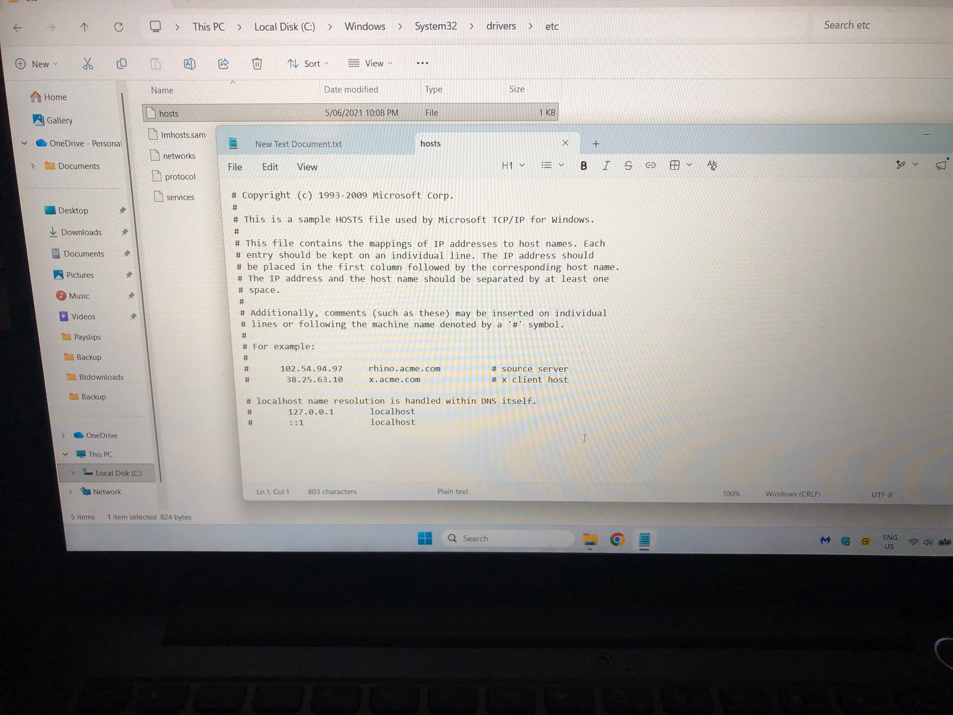

Edited: From a Norton support article this is what the standard host file should look like without and custom entries:
Create a new Windows hosts file?
Copyright (c) 1993-2006 Microsoft Corp.
  # This is a sample HOSTS file used by Microsoft TCP/IP for Windows.
  # This file contains the mappings of IP addresses to host names. Each
  # entry should be kept on an individual line. The IP address should
  # be placed in the first column followed by the corresponding host name.
  # The IP address and the host name should be separated by at least one
  # space.
  # Additionally, comments (such as these) may be inserted on individual
  # lines or following the machine name denoted by a '#' symbol.
  # For example:
  #    102.54.94.97  rhino.acme.com   # source server
  #    38.25.63.10   x.acme.com       # x client host
    # 127.0.0.1 localhost
    # ::1 localhost

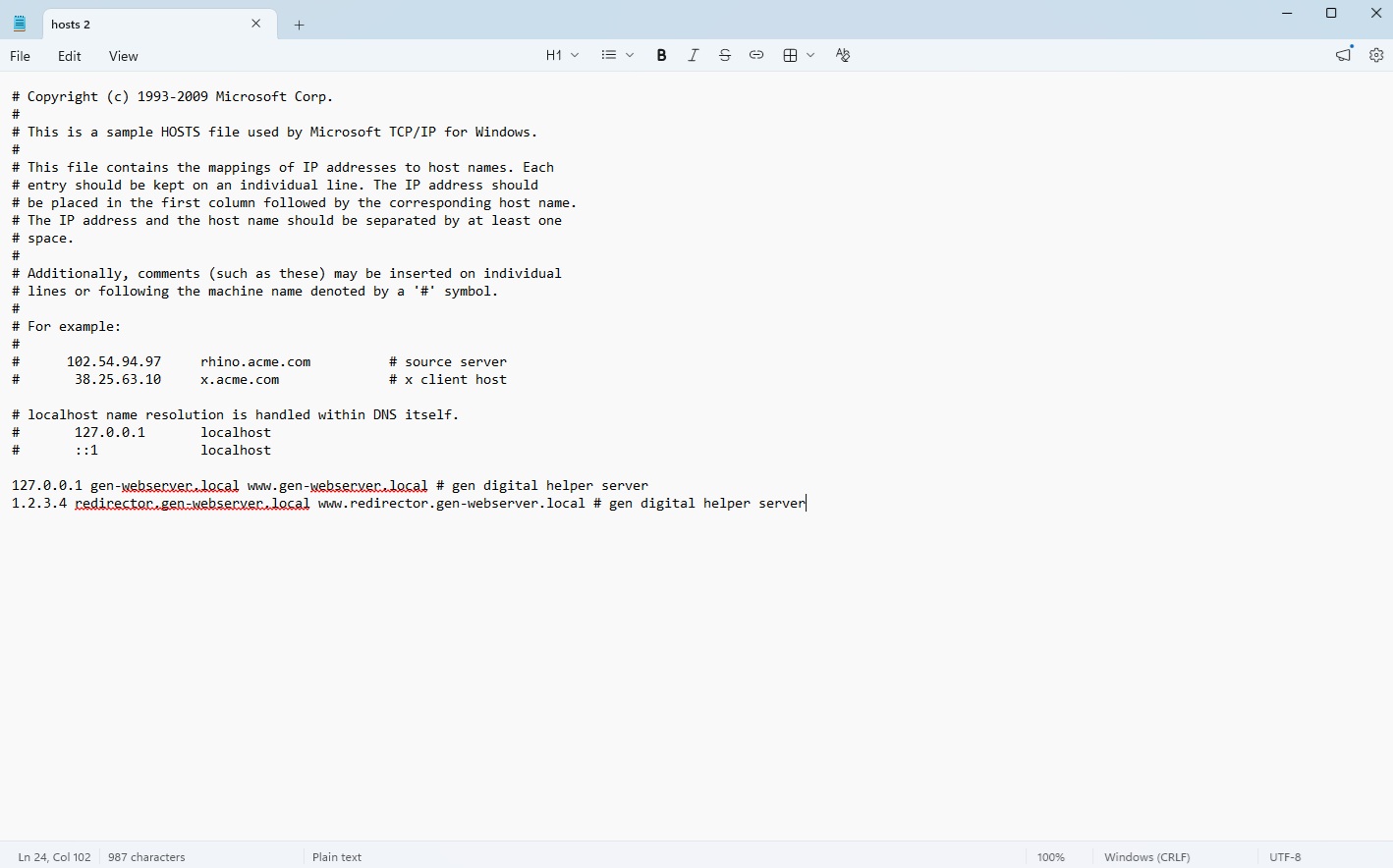

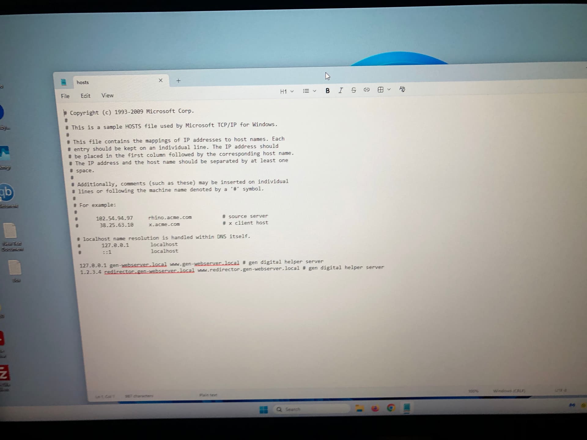

I think we are missing the really dangerous and problematic issue we are facing.
yes you can restore the hosts file back to it’s normal state.

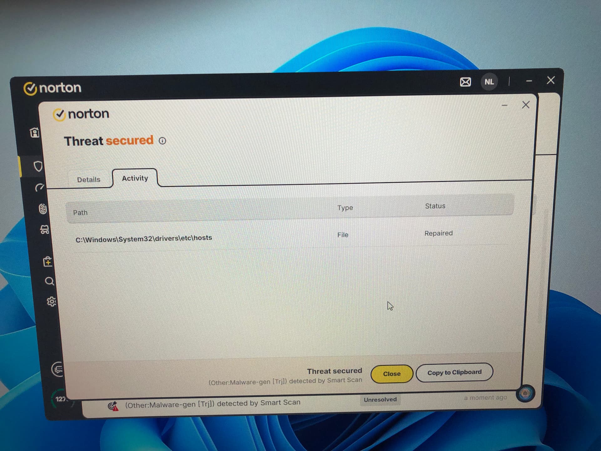

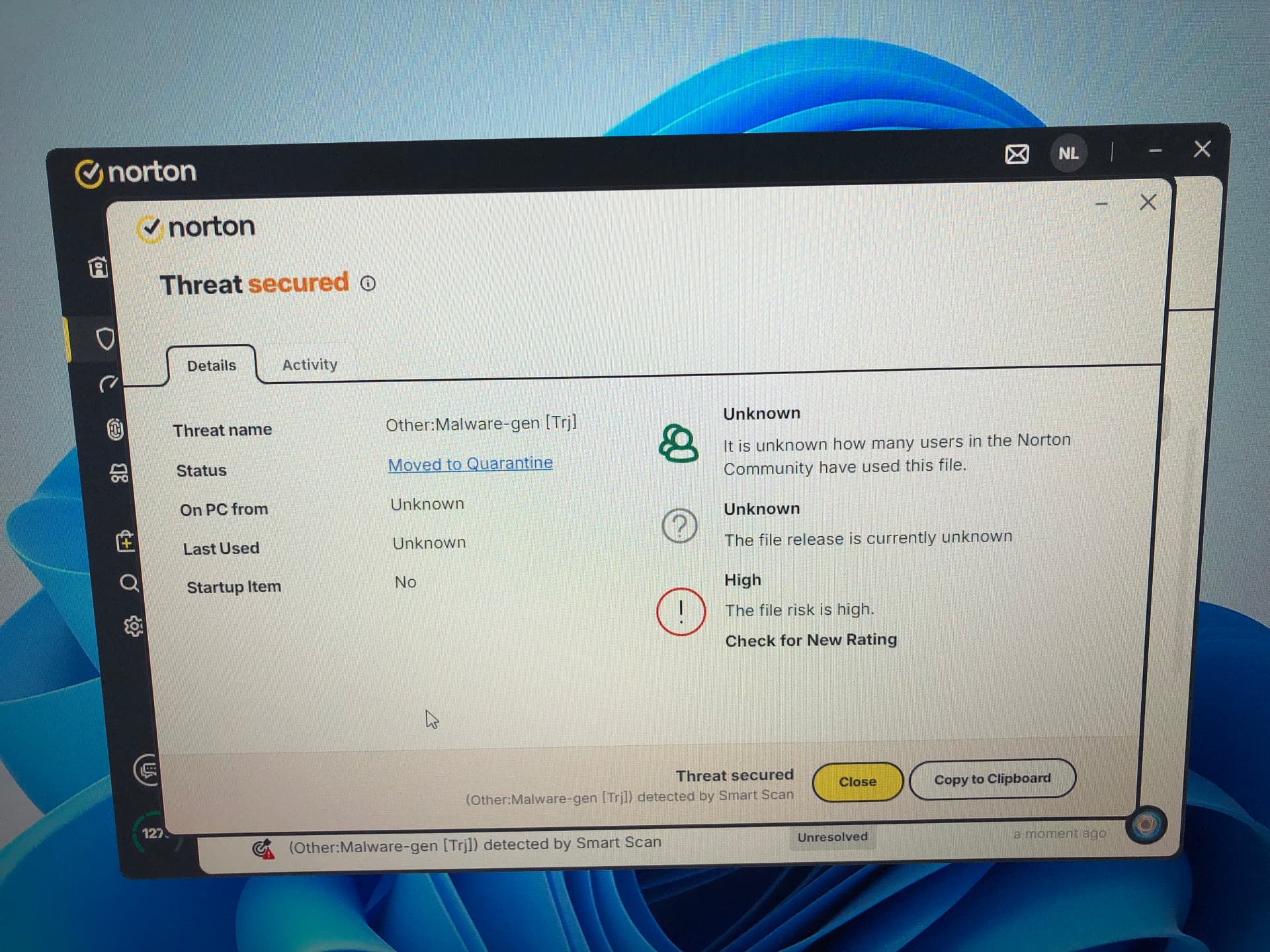

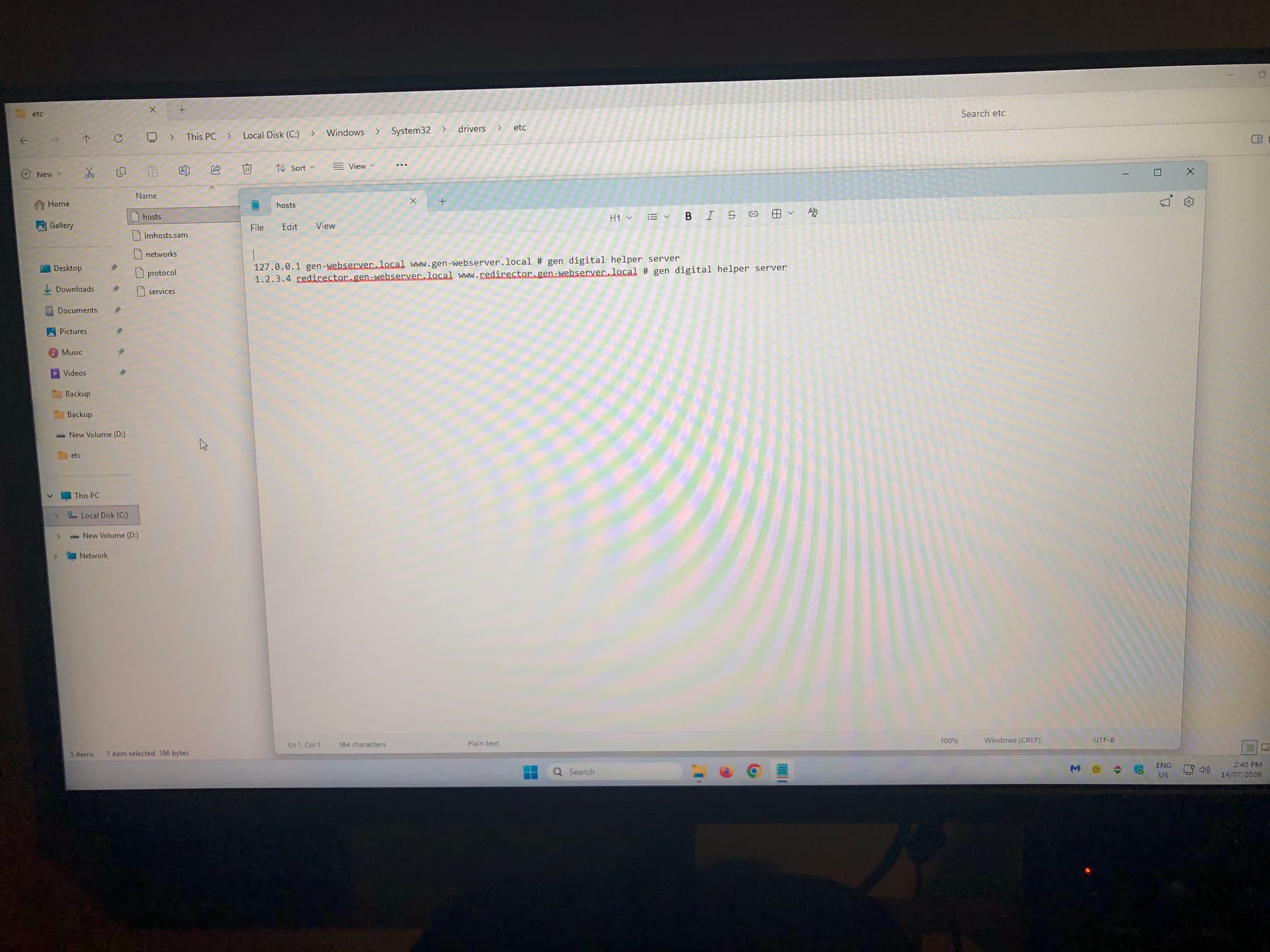

But as soon as you restart your computer Norton adds the lines at the bottom of the next photo
So this is an issue that cannot be SOLVED norton always puts their code back into the hosts file even when you restore it.

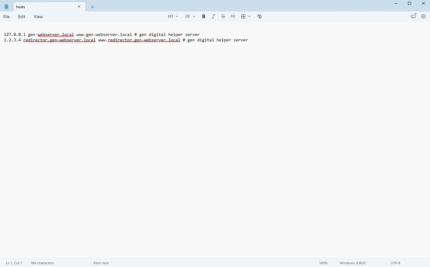

if you do opt to clean the malware it will delete the hosts file but when you reboot it adds a new hosts file with just this.
It was my understanding when the hosts file is changed it’s usually done via malware.
With the redirect of traffic through these address are we even safe? 1.2.3.4 is a real IP address.
127.0.0.1 gen-webserver.local www.gen-webserver.local # gen digital helper server
1.2.3.4 redirector.gen-webserver.local www.redirector.gen-webserver.local # gen digital helper server
This needs to fix fixed now as there is NO work around. This needs to be escalated and fixed Today. This is a terrible security flaw that is happening right now.

@xjoex Respectfully, I disagree with the statement "The situation is neither dangerous nor problematic". The dangerous part is yet to be determined. ** Please read my latest post here for some clarification as we await Norton and their review.
The problematic issue from where I sit is data privacy. Everyone here SHOULD realize one thing if nothing else. The below domains are NOT accessible via a web browser.** No software that I have ever owned has written entries into my hosts file. Ever!! Others may have experienced a different scenario, which should be regarded as alarming at the very least. Windows itself, would NOT automatically alert the user that those entries were present and the hosts file had changed. Without a third party A/V solution installed Windows Defender most certainly WILL. In Windows Defender you can add exception per this info:

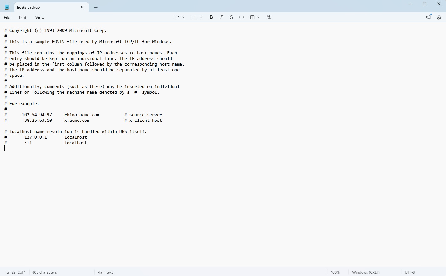

Norton overwrote existing valid entries in my hosts file without making a backup of the file, essentially deleting part of my network configuration. If I add them back, it will overwrite them again. How is that not problematic?
@Brian_XXX When you re-create your hosts file and put it back into the directory it belongs, set the file properties to “read only” and save the file. Reboot. Otherwise Norton WILL rewrite the entries back into hosts. There is another thread specifically about this issue here:
