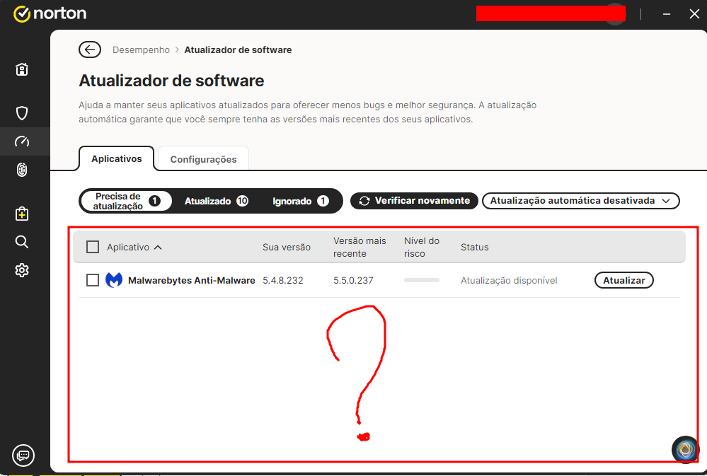

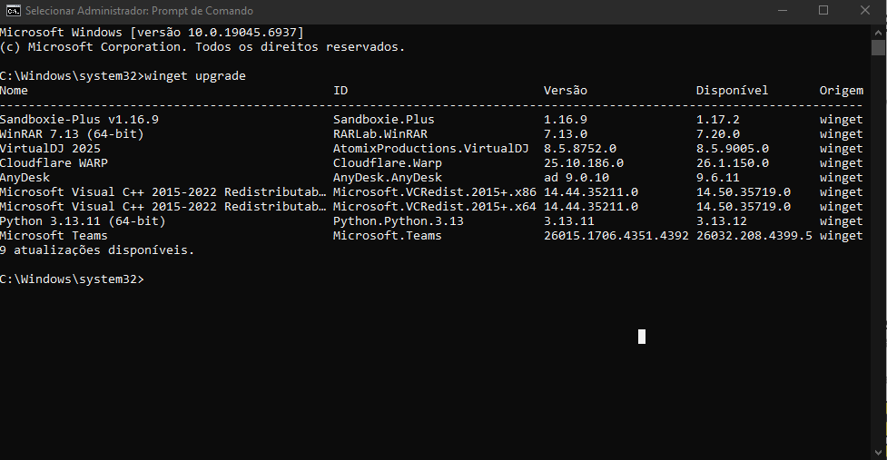

Hello, I have all these programs listed below that need updating. This information is obtained through the CMD command using winget upgrade.
When I open the Norton program update tool, I’m disappointed to see that Norton doesn’t show the programs that need updating.
Why is this happening, and why hasn’t it been fixed yet?
This means Norton is leaving me unprotected by not updating these potentially vulnerable programs.
