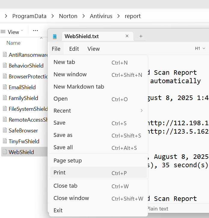

Print from File menu. Export to where? Download to where?

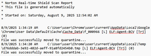

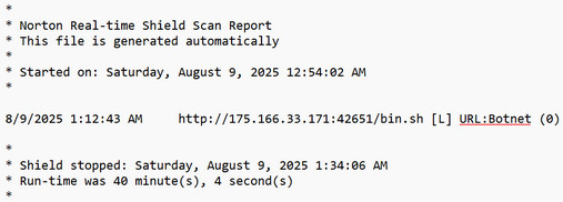

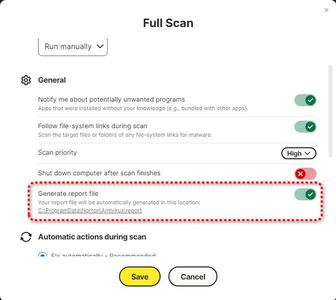

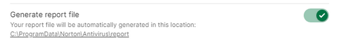

Norton 360 Scan reports reside with \ProgramData
Maybe, I’m reading your opening post wrong?
Hi bjm. Thanks for this information. Unfortunately, I’ve used Norton 360 for a long time but had not delved deeply into all of it’s features, some of which may be new. This became recently important when I did a large file copy and Norton ran automatically and unexpectedly found a number of problems with the destination copies. When I started looking at the scan logs through the user interface, I did not see report options you cite. I also did not find any reference to the report generation feature during any online searches I did. Unfortunately, the option you referenced seems to apply only to scans run after the option is set. However, what I want to be able to do is generate a file or report historically, e.g. for a scan run on 8/6/2025, prior to me setting the report option The data is clearly there, since I can see it through the Security History tab. I just think there should be a way to access (download) it to generate a historical report using Excel or print the data retrospectively.

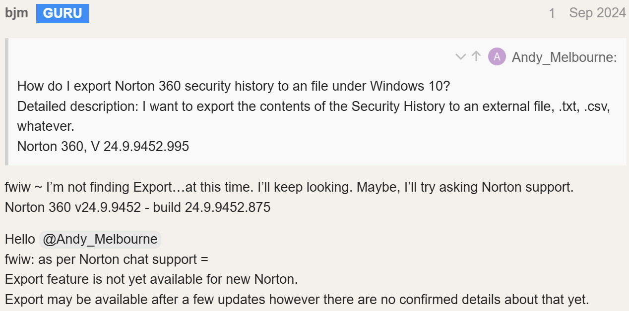

v24+ Security History is not v22 Security History
v24+ Scan report is minimal vs v22
You’re not missing much by just now enabling report.
sounds reasonable. I’m not aware how.

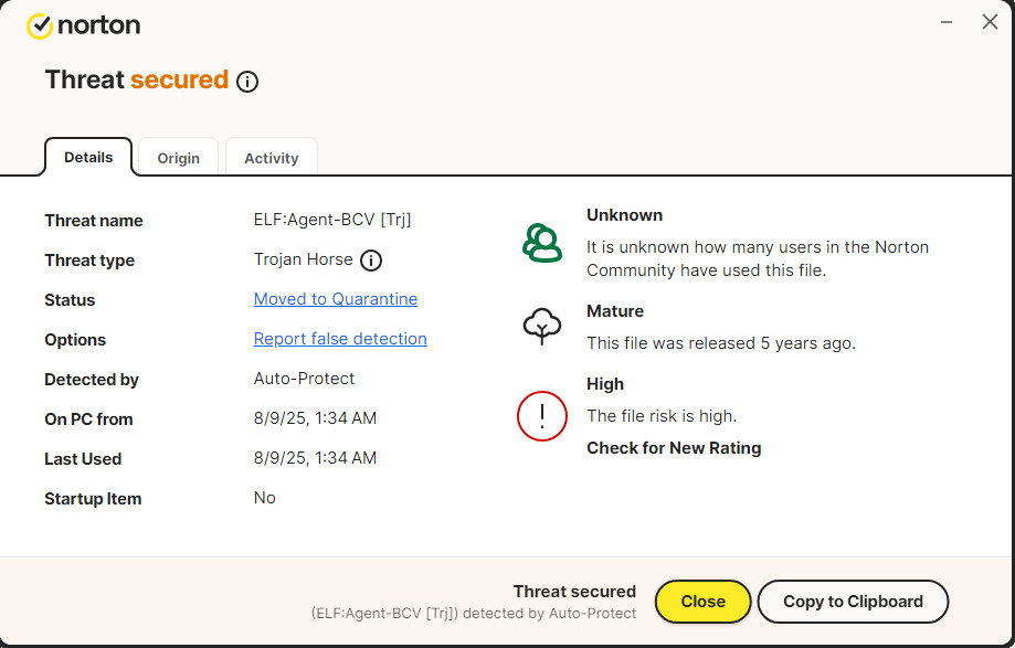

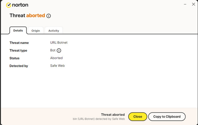

Maybe, screenshots & Copy to Clipboard will satisfy for now.
for example:
Details
Threat name: URL:Botnet
Threat type: Bot - This threat recruits your computer into a network of other computers and provides its computing resources to the network on command.
Status: Aborted
Detected by: Safe Web
Origin
Downloaded from: http://175.166.33.171:42651/bin.sh
Activity
Path | Type | Status
http://175.166.33.171:42651/bin.sh | URL | Blocked
Details
Threat name: ELF:Agent-BCV [Trj]
Threat type: Trojan Horse - This threat pretends to be something else (e.g., picture, document, or other file) to trick you into running it and infecting your computer.
Status: Moved to Quarantine
Options: Report false detection
Detected by: Auto-Protect
On PC from: 8/9/25, 1:34 AM
Last Used: 8/9/25, 1:34 AM
Startup Item: No
Unknown
It is unknown how many users in the Norton Community have used this file.
Mature
This file was released 5 years ago.
High
The file risk is high.
Origin
Activity
C:\User\user\Chrome\user\current\AppData\Local\Google\Chrome\User Data\Default\Cache\Cache_Data\f_000966 | File | Repaired

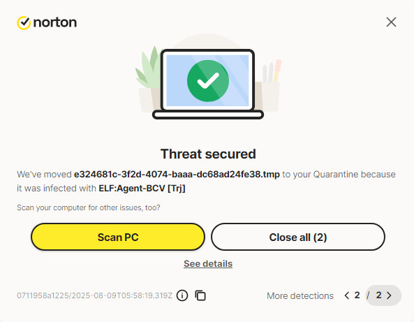

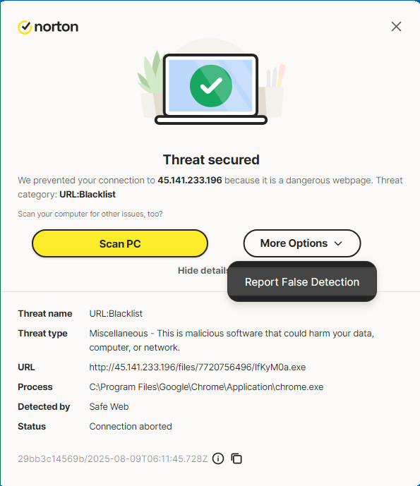

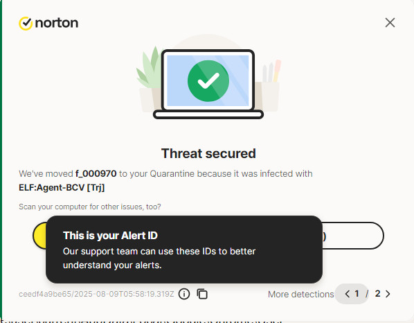

Review recent security or other events with Security History here
real-time alerts provide Alert ID
for example:
29bb3c14569b/2025-08-09T06:11:45.728Z
ceedf4a9be65/2025-08-09T05:58:19.319Z
0711958a1225/2025-08-09T05:58:19.319Z
