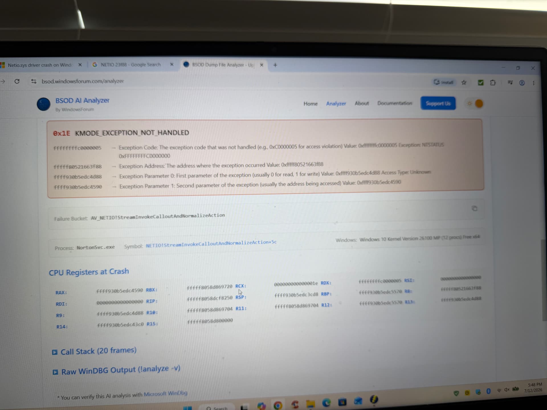

Clear pictures added. Windows 11 reinstall recently with Dell image with all updates as well. Where do I get the error and exception codes with fault bucket? Think I found them.
The computer has rebooted from a bugcheck. The bugcheck was: 0x0000001e (0xffffffffc0000005, 0xfffff80415543f88, 0xfffff2085e934d88, 0xfffff2085e934590). A dump was saved in: C:\Windows\Minidump\071226-7328-01.dmp. Report Id: 5b2dfe71-9258-4b14-982a-380a30d6e57c.

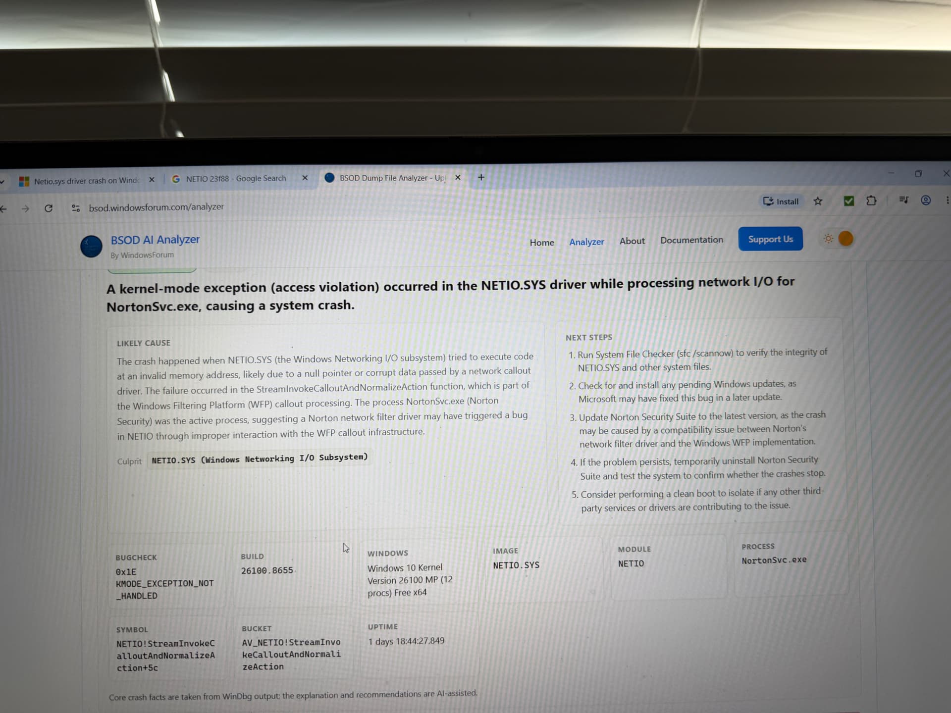

Reviewing the fresh screenshots the bug check 0x0000001e applies from my earlier post. The screenshot does show the culprit as NETIO.SYS ( Windows Networking I/O subsystem ). The fault buckets are:
Note: These buckets are NOT always caused by third party security. My suggestion is removing Norton and run the laptop a few days to see if this returns without Norton installed. If it does there is some sort of driver incompatibility happening.
Windows bucket : AV_NETIO!StreamInvokeCalloutAndNormalizeAction

Norton bucket : AV_NETIO!StreamInvokeCalloutAndNormalizeAction+5c

Have you reviewed the dump file at C:\Windows\Minidump\071226-7328-01.dmp ?
