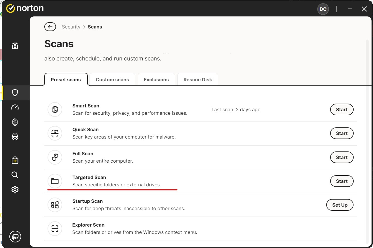

and you have Targeted Scan & Explorer Scan enabled?
as test: Scan selected… txt, exe, pdf = Explorer Scan prompt

Okay…looks like you’re setup okay.
That’s nice and all… but it doesn’t fix this issue that I have, which is that when I right click on a file and select the Norton Antivirus option to scan it… nothing happens.

Hello! I’m running Norton version 25.5.10141 and I’m unable to get Norton to scan a specific file after I right-click on it & then go to “Show more options” & then hover over “Norton 360” & then left-click on “Scan selected item for viruses”. Please note that I do have Targeted Scan & Explorer Scan enabled. Any ideas, please?
and you’ve run Norton LiveUpdate and Restart (not Shut down) machine?

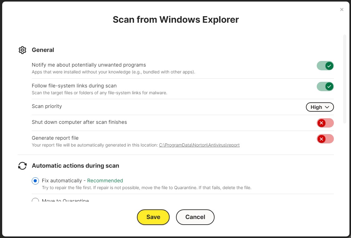

and you’ve reviewed Targeted Scan & Explorer Scan settings

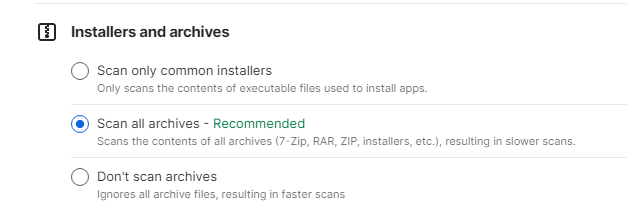

  1. I have ran Norton LiveUpdate numerous times and it completes without any problems.
  2. Please clarify what you mean by “run Restart (not shutdown) machine” - are you referring to the Restart option within Windows 11 or a Restart option within Norton itself?
  3. I have definitely reviewed Targeted Scan & Explorer Scan settings and they are both set to the “Scan all archives” option - as you indicated in that screenshot.
