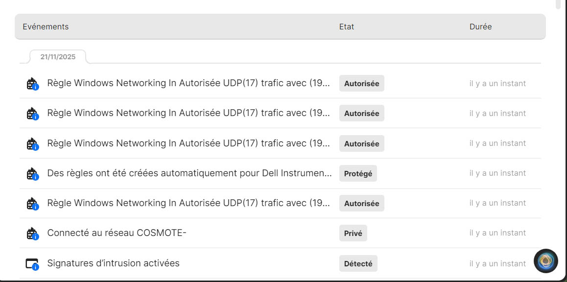

I forgot to ask if your Norton install is version 25.11.10580 (build 25.11.10580.0). Also are there entries in the Norton history showing that Cast is being blocked? If so could you please post a screenshot for review? I am able to Cast but only to certain devices and websites from Opera GX on Windows 10 Pro without any issues, I am on the version of Norton noted earlier.
I have the version 25.11.10580 just manually updated. I send you the screenshot of the history just after the reset, everything seems OK but always no cast with the firewall on

Anything new in the history area since your last post?
Always the same, no cast…
