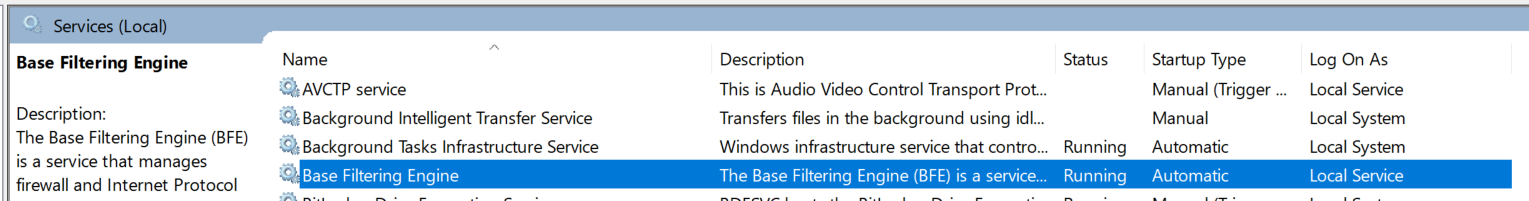

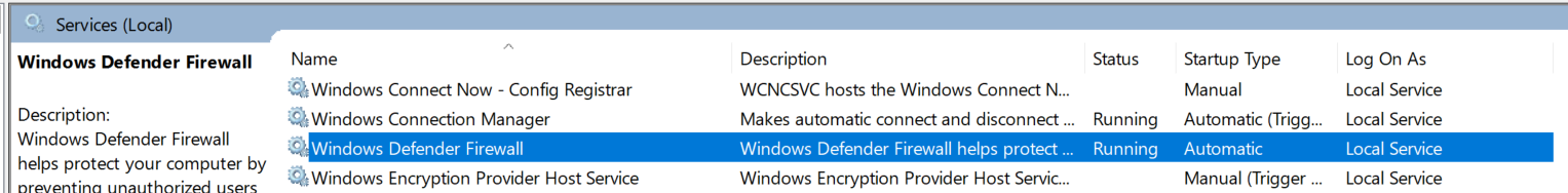

Base Filtering Engine → Running Automatic
Windows Defender Firewall → Running Automatic

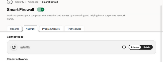

Why this happens with Norton 360
  • Corrupt Installation: A “dirty” update can leave Norton and Windows fighting for control over the same network ports. Using the Norton 360 Remover tool often fixes this by cleaning out old registry rules .

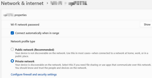

  • Network Profile Flips: Norton sometimes incorrectly flags a home network as “Public,” causing the Windows Firewall process to spike as it applies stricter security rules. Ensure your network is set to Private in both Windows and Norton settings.
I did confirm that Base Filtering Engine & Windows Defender Firewall are running in Automatic.
