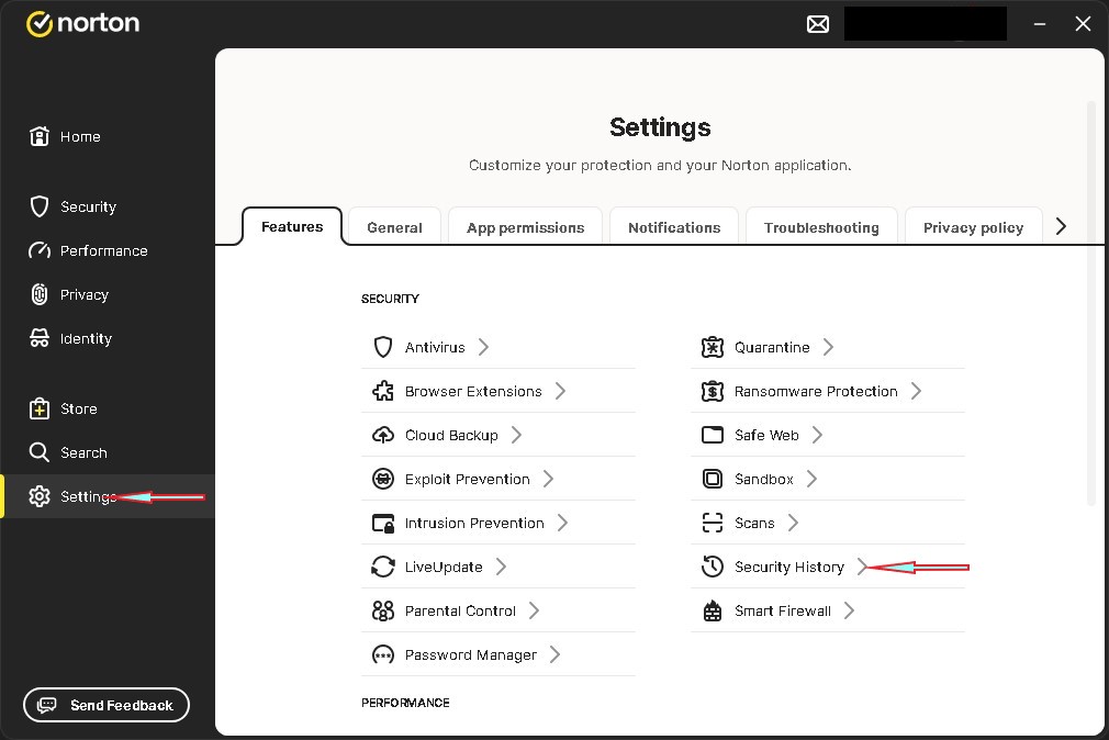

You can open your Norton history following this: ** Look for entries during the overnight hours around the time you put your device to sleep. The disconnect should be happening at that specific time since the computer was not actively running. Please post a screenshot of what you may see for review. TIA.
