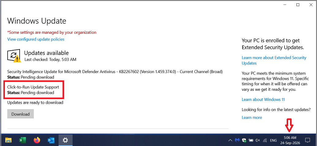

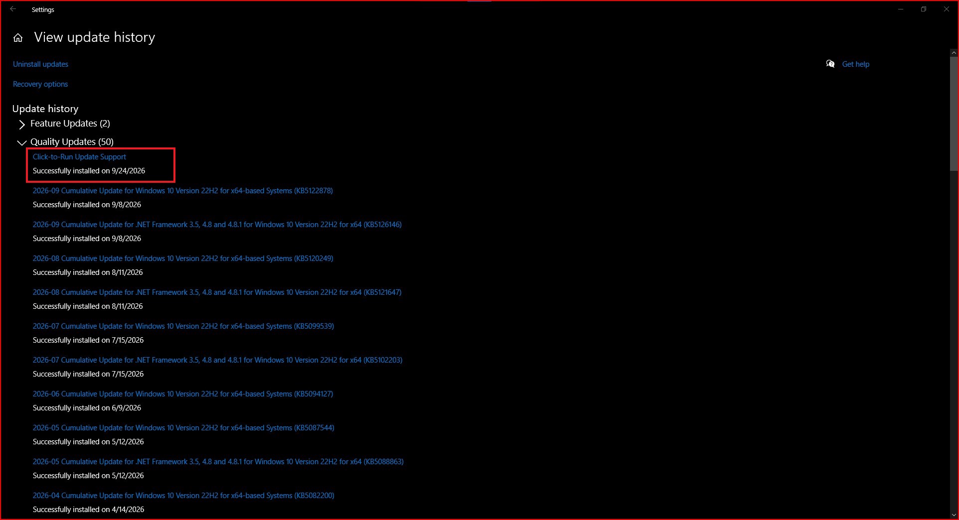

My “perpetual” retail edition of Microsoft Office Home and Business 2019 C2R was affected by this bug after an automatic Windows Update delivered an update on 24-Sep-2026 called “Click-to-Run Update Support“ that was NOT optional (i.e., entering wmic qfe | find “KB5002907” in an elevated command prompt shows I did not receive the optional KB5002907 described in that BleepingComputer article). See my 24-Sep-2026 post # 2880629 in Richard Mitnick’s Office Updates in the AskWoody forum for further details.

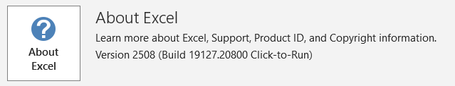

My retail edition of MS Office 2019 C2R reached end of support on 14-Oct-2025 and the release history <here> still shows that Version 2508 / Build 19127.20302 (rel. 14-Oct-2025) is latest available version, but since the forced re-install and re-activation on 24-Sep-2026 my product is now at Version 2508 / Build 19127.20800 (a.k.a. v16.0.19127.20800).

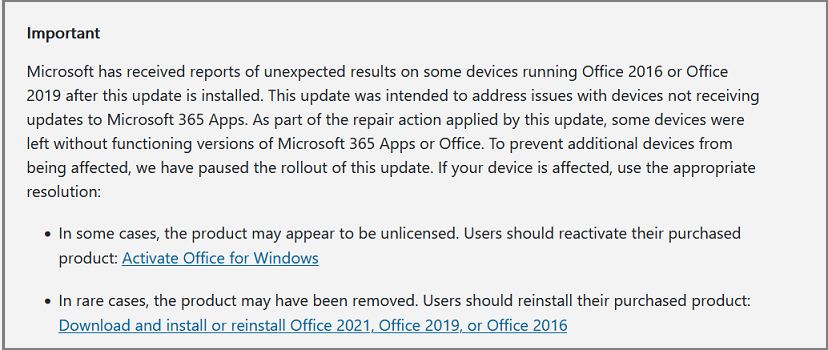

The link in that Neowin article only points to the MS support article KB5002907: Optional update for out-of-date Microsoft 365 Apps installations, which says that some affected MS Office 2016 and 2019 users may have to perform a clean reinstall of their Office product to get it working correctly again . That’s not much of a “fix” in my opinion.

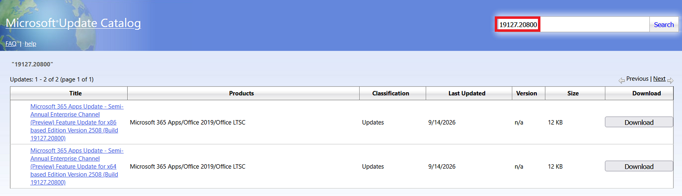

At this point I’m not even sure if I will need to reinstall my Microsoft Office Home and Business 2019 C2R, but I’d like to delay that decision until Microsoft figures out why the problematic KB5002907 was pushed out to out-of-support Office C2R installations in the first place. All my Office programs seem to be working correctly since KB5002907 "Click-to-Run Update Support“ update triggered an automatic online repair that installed Version 2508 / Build 19127.20800 on my system, but according to a Microsoft Update Catalog search <here> this build is a 14-Sep-2026 “Semi-Annual Enterprise Channel (Preview) Feature Update” for Microsoft 365 Apps/Office 2019/Office LTSC.

According to the Microsoft support article KB5002907: Optional update for out-of-date Microsoft 365 Apps installations the “Click-to-Run Update Support“ update was released on or around 24-Sep-2026 to fix the following problem :
“This optional update is available only for Windows PCs with Microsoft 365 Apps installations that are more than 90 days out of date and use Current Channel or Monthly Enterprise Channel. Installing the update can help the apps resume updating and move to a current build for the device’s assigned update channel … Consider installing the update if Microsoft 365 Apps on your Windows PC is more than 90 days out of date or has stopped updating normally.”
Windows Update delivered this “Click-to-Run Update Support“ update to my Win 10 machine as a mandatory (i.e., not optional) update, and I suspect it was incorrectly pushed to out-of-support MS Office 2016 C2R and 2019 C2R (and possibly MS Office 2021 C2R, which doesn’t reach end of support until 13-Oct-2026) products by mistake because of a glitch in the metadata that incorrectly targeted ALL Microsoft 365 and Office products that had not been updated in the past 90 days.
