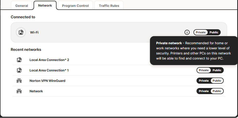

Public (cafe icon/white)
Public network - Recommended for public networks, like in a cafe or airport, where you need a higher level of security. Printers and other PCs on this network won’t be able to find and connect to your PC.
Private (home icon/white)
Private network - Recommended for home or work networks where you need a lower level of security. Printers and other PCs on this network will be able to find and connect to your PC.

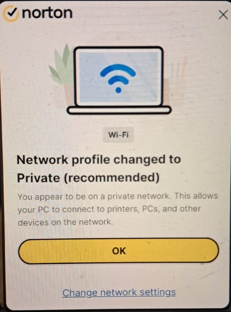

as to what’s recommened…Windows vs Norton…my network…I do not need other machines discoverable nor connect to other machines/devices. I opt Public. Just me
We’re restricting incoming traffic on this network
You appear to be on a Public network, so we increased your security.
