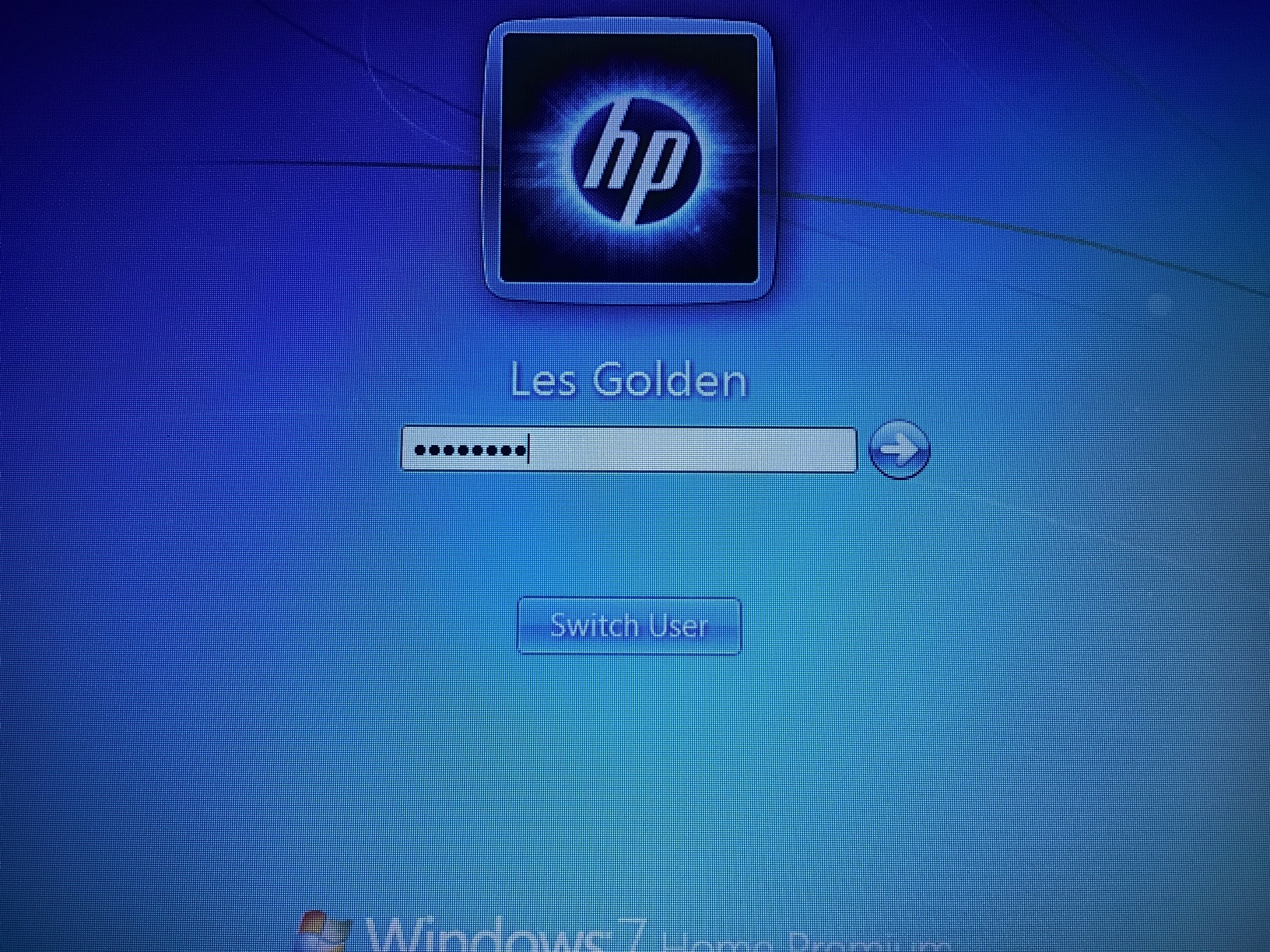

Missing switch user button on W7
New norton version has now caused switch user button to dissappear from login screen on W7 laptop, any update going to patch it?

Not Windows, when I uninstall Norton and turn off then boot up laptop again, it goes back to normal login with switch user button and fingerprint reader works like it’s always done.

I’ve unistalled and reinstalled 360, but use task manager to go to login and switch user is there, but log off and shut down then boot up again and switch user button has gone, I’ve gone into the register and checked that a registery key is set to 0, and it is so nothing to change there.
