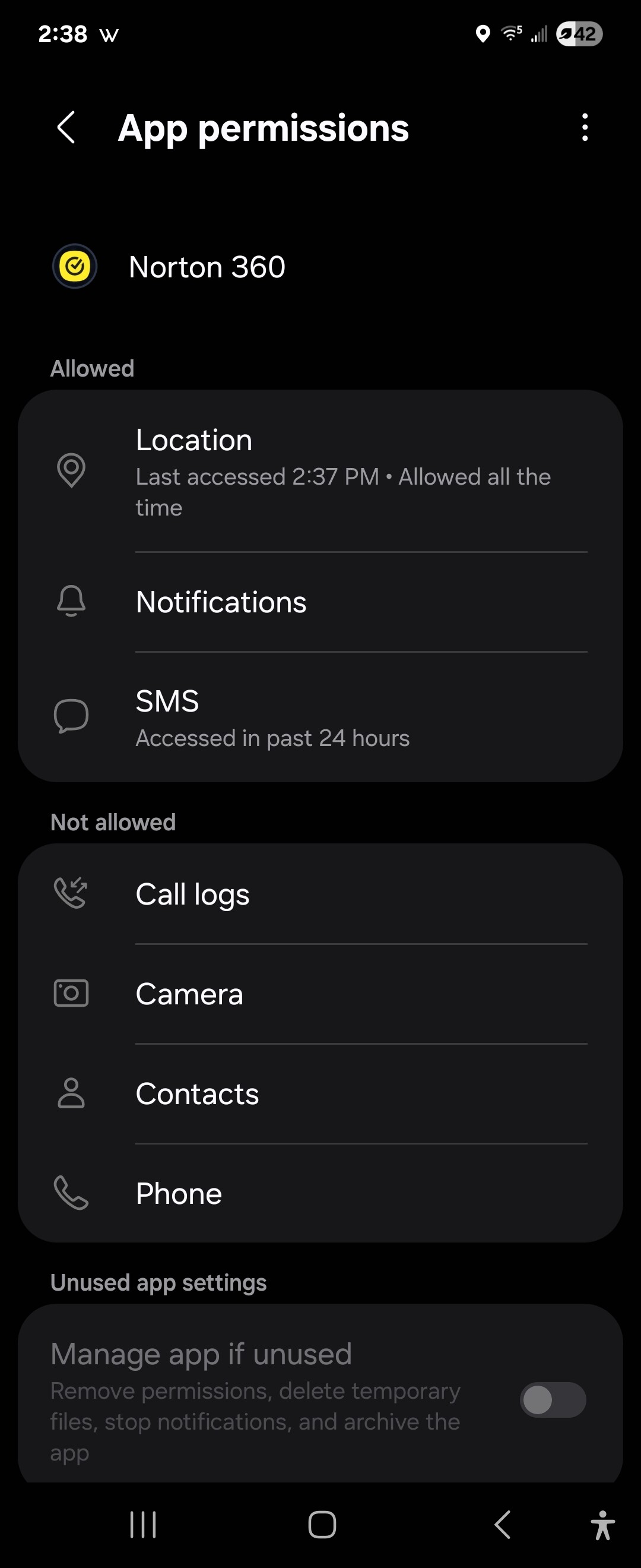

These are my settings on my Samsung Z-Flip 5 on Android 15 with UI 7.0 . What you see on your side may vary. IMA that I use my device on Wifi within my home network for than anything else so my data shows very low usage.

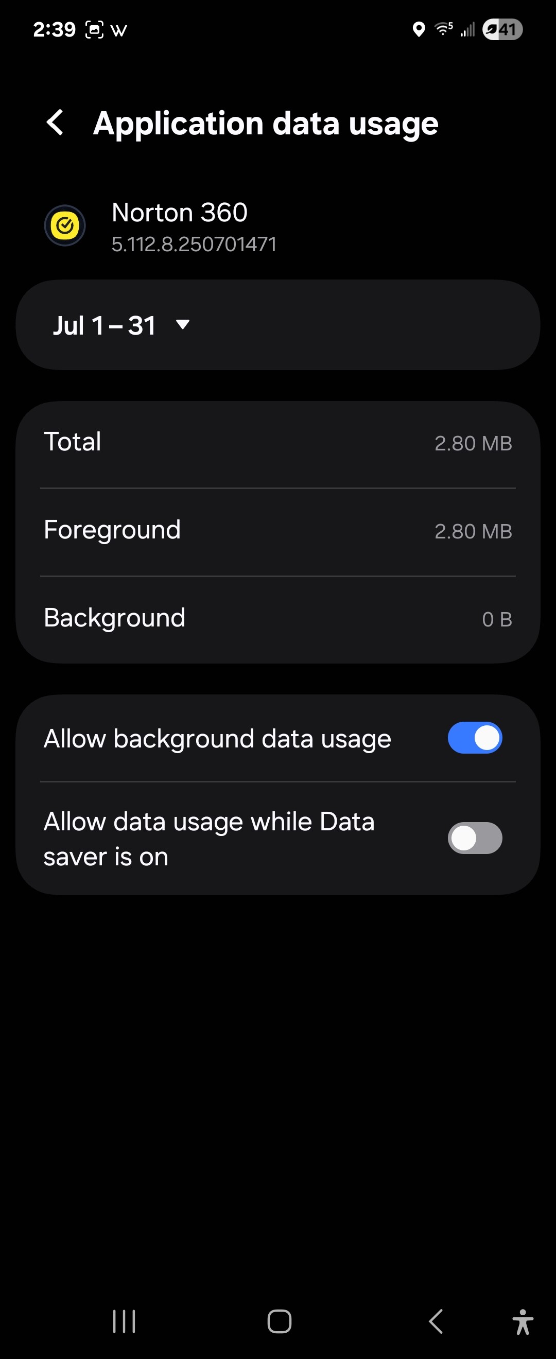

Thank you. Interestingly, the (app) permissions show me that the Norton app consumes a small amount of mobile data (2 MB per day), while at the same time I am informed that mobile data is blocked. All in all, this looks like a serious bug in Norton 360 to me.

Thanks for your post back and sharing your information. The screenshots I posted appear to validate the data usage as being inaccurate as well.
