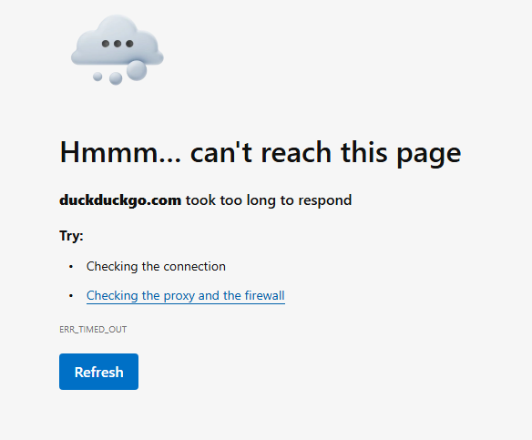

MS Edge, non-Bing Search Engines, and Norton 360 VPN issues
Issue abstract: Issues with MS Edge InPrivate browser while using non-Bing search engines, and Norton 360 Premium VPN turned on.
Detailed description: When using the Windows Edge InPrivate browser with non-Bing search engines (Google & Duck Duck Go), and the Norton 360 Premium VPN turned on (I tried both Canada and Denmark), I don’t get any results. Only the time-out error shown below.
Per a chat session with a Norton chat-bot, I reset my home network on this computer, I reset Norton, and I restarted everything. No help. I turned Norton 360 Ad Tracker Blocker on and off. No help. I checked the Firewall. No issues there (as far as I can tell). The only search engine that works with the Edge InPrivate browser is Bing. Everything works fine with the regular Edge browser and Chrome; the issue only occurs with the InPrivate browser.
Background note - There was a service outage in this area last week. When it was over, my internet service did not come back on. My provider’s Customer Support determined that my router had gone bad and I replaced it. That fixed the service problem.
The above connection problem didn’t exist before the outage & router replacement. The Edge InPrivate browser and Duck Duck Go search engine worked fine with the Norton 360 Premium VPN turned on. After the outage, and the new router, they no longer work together.
Suggestions?
Product & version number: Product 25.12.10659 Build 962
OS details: Win 11
What is the error message you are seeing? Search engine site took too long to respond
Search Engine requests: Duck Duck Go & Google
