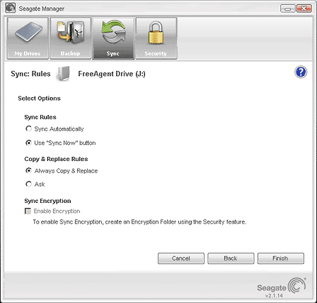

Sorry it took me so long to answer your question. In order to answer it adequately, :smileywink: I needed to get some screenshots, which meant reinstalling :smileysurprised: the software again, which I procrastinated doing for a while, but I finally got around to it. It's now uninstalled again, hopefully this time permanently ;) but anyway here's a little bit of info about it.
The software that was pre-installed on the hard-drive is called "Seagate Manager", and it's version 2.1.14.0. Here's a screenshot of the main window, scaled down a little to fit on the forum better:
Doing a "Properties" on the app's "stxmanager.exe" show that its digital signature was on July 30, 2008.

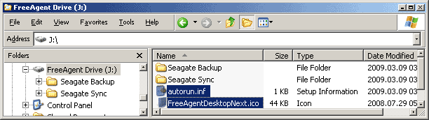

One of the probably-trivial things that annoyed me about the Seagate software, was that every time it ran, it would re-create an "autorun.inf" file and a "FreeAgentDesktopNext.ico" file at the root of the HD. I'd delete those two files, and they'd reappear later. They were probably harmless, but I didn't like it doing that for no good reason. If I delete an unnecessary file, I expect it to stay deleted, not keep being recreated all the time. The two perpetually-recreated files are the highlighted ones in the following picture:
I don't know how to interpret autorun.inf files, but this one might (?) be related to the Seagate icon, assuming that's what the .ico file is? After all the Downadup ruckus about autorun stuff, I'm naturally suspicious of it. I don't know what the first line does though - here it is opened in Notepad:
Although why in the heck a Windows machine needs special drive icons when Windows doesn't display icons on the desktop anyway (like some other OS's do), is something I don't understand. Even with those two files in place, the Seagate HD icon looked just exactly like all my other drive icons, so I don't know what the icon's purpose was. If it's actually an icon, that is (I don't know how to determine such things). I should have made a copy of those two files but at the time it seemed like screenshots were sufficient; now I'm not so sure.
Also, apart from any security issues, the Seagate Manager backup/sync functions were pretty lame. For one thing, you couldn't set the sync preferences or even tell it to "Sync Now" (see pic below) unless you were logged in as an administrator :smileymad: :smileysad:  (at least on XP, when backing up a folder on one of the main HD's partitions, to the Seagate HD), and what security-conscious person runs as an admin all the time? I certainly don't.
It's a shame too, because the software had potential to be useful, like the would-have-been-convenient little taskbar-menu with its "Sync Now" feature which, sadly, again only works for administrators:
I finally figured out that by playing with various permissions I could get the Seagate software to do only the real-time sync (not what I wanted; I wanted manual sync) if I'd set the settings while logged in as an admininistrator, but I did not want the real-time sync - I just wanted to be able to sync two folders manually, when it's appropriate (like once or twice a day or after making important changes to files), because that way I get a little bit of extra protection there in case I've screwed up one of my files, it won't instantly be copied into the sync folder like the Seagate software did. But with Seagate Manager I could not run manual syncs while running under a Limited user-account. Really stupid for Seagate to design it like that :smileysad: because it just gives users yet another reason to run as admin all the time, which is a bad idea from a security standpoint. Anyway enough about that aspect of it. :smileywink:
Oh, the other weird thing about the Seagate software, is that the backups never matched anyway - number of files/folders were always a lot different (off by HUNDREDS of files!!), so I didn't trust it anyway - like, where were all the rest of my folders etc?!? No, I don't use very long file-names either, so it wasn't the 200-whatever character path-name thingie I've heard about elsewhere. And it was only about 4 gigs worth of stuff I was trying to sync, and all of it had the same permissions.
