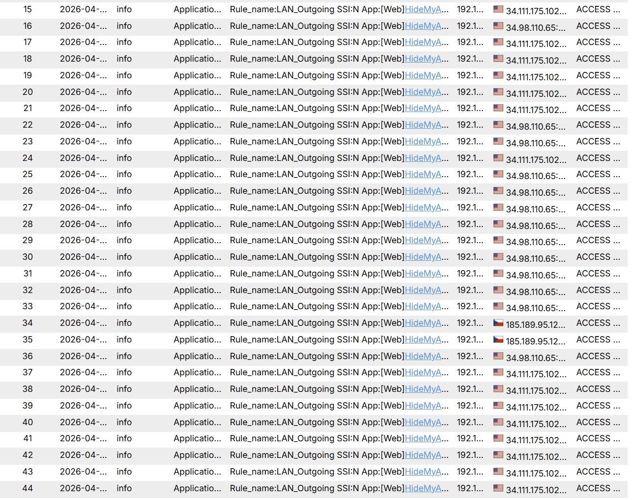

After one of the last few product updates, none of my devices are transmitting data to Norton for the protection report, nor can they display the device security on each device’s product.
One new problem that correlates with this issue:
Ever since this Norton product update when the device security reports discontinued working, my firewall has been constantly receiving traffic from “HideMyAss”, and ONLY from the devices that have Norton installed (my PC’s and phones). Out of 60+ devices trafficked through the firewall, only the 9 devices with Norton 360 installed have been sending this traffic.
Is Norton now using HideMyAss for its products to transmit data to the Norton servers?
If I remove Norton from a device, the HideMyAss traffic is no longer being transmitted from the device and no longer logged on the firewall. I cannot find anywhere on the internet or Norton’s pages where HideMyAss is mentioned, and can only reasonably assume is it via their partnership with GenDigital, unless Norton is using HideMyAss on its own and not informing the customers, but why would Norton NOT use their own VPN service?
Can anyone provide any information on this? I have used Norton for a long time, but the service has become mainly marketing focused on everything else but security since the acquisition of Avast.
I am going to be up for renewal soon, and I cannot renew Norton if they are using HideMyAss or other anonymizers in their products, or worse, if my protection is subpar due to blocking HideMyAss via my firewall.

@jayd691 Filtering through all the non sense posts that don’t address your questions directly. I will escalate this thread to Norton forums Admins for review. Being we Guru’s are not Norton/Gen Digital employees we cannot say whether what you are seeing is by design on the part of Norton or isn’t. I will do my very best to get some direct answers for you.
@nivasraja Could you or your team please advise regarding the issue @jayd691 is having? This is a pretty big issue that needs a direct answer from Norton as we Guru’s don’t have that answer officially.

Our engineering team would like to review diagnostics from one of the affected devices to understand both the HideMyAss-related traffic you’re seeing and why your devices stopped contributing to the Protection Report.
Please use the following KB articles to gather logs from the respective platforms
Windows: Send Norton product debug logs with Norton Support Tool (Share the File ID once the logs is completed)
Mobile: Collecting debug logs if Norton 360 app encounters an error on your mobile device
I am running the support tool to send logs (if it finishes). I have attached a snippet of the firewall logs while the Norton Support Tool is running.
ZDQFR - File ID for Support Tool Debug Logs

I have the zip file from the Norton Support Tool. I tried twice to upload it but it failed both times due to the HideMyAss blocked at firewall. I did verify that only the devices with Norton Security installed are sending HideMyAss traffic. Also, one new device did not send HideMyAss traffic to the firewall until I installed Norton 360 on it. Once I installed Norton, the HideMyAss traffic started coming from that device too.
Finally, the destination ip addresses with the HideMyAss comes back to Google Cloud customers.
Norton is not going to address their hidden use of HMA? I have cancelled my auto renewal and will be switching providers very shortly. There cannot be trust with an entity when they secretively use hma vpn without informing customers, especially when Norton has their own vpn they can use. Cannot verify protection reports due to the hma issue.
I have removed Norton from one machine for a few days, and instantly no more hidemyass traffic from that ip address was hitting the firewall. I will try another AV provider that is less marketing focused, does not sell as much data, and does not give false results in an attempt to sell other products like the anti-tracker.

Hello @jayd691 ,
Sorry for my delayed response.
We do want to get this reviewed properly by engineering, but I do not want to speculate on the traffic behavior until the team verifies it from diagnostics.
Since the tool upload is failing in your environment, the best next step is for us to work with you directly through the email address associated with your Norton account so we can help collect fresh diagnostics from an affected Windows device.
If you are okay with that, please confirm here that you give permission for us to contact you by email, and we will take it forward from there.
Thank you again for your patience and for documenting the behavior so clearly.
Hi @nivasraja, I did some more testing on a backup machine and when Norton is removed, the traffic stops. I used the Norton removal tool and then cleaned up all leftover files, reg entries, etc. Since I knew it was related to Norton only, I tried to enable the VPN and, sure enough, it looks like Norton has switched over its vpn service to use the HMA obtained during the acquisition as I could not get an ip address and firewall logs kept coming as I tried the vpn. I am guessing Norton is also using this to transmit the data, although it still does not update on the my account page. Unless there is something else you would like assistance with, I am confident this is the problem I have, and also will not be able to use VPN service as I will not allow HMA through my firewall. I would say that Norton should look into why there is so much traffic constantly going out from the security products however. It is sending a lot of traffic and almost acting like a small ddos as it is eating up cpu on the firewall blocking and logging from 9 devices.
