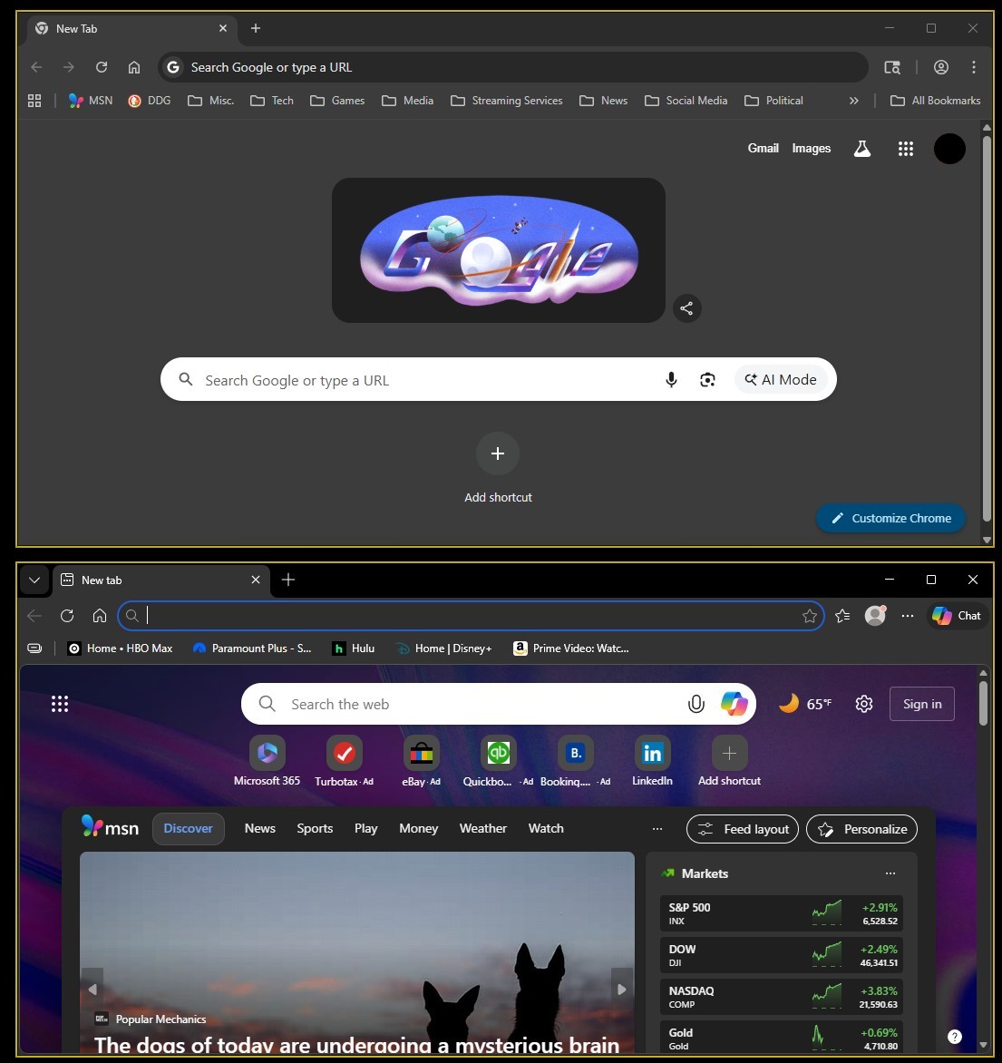

Hello,

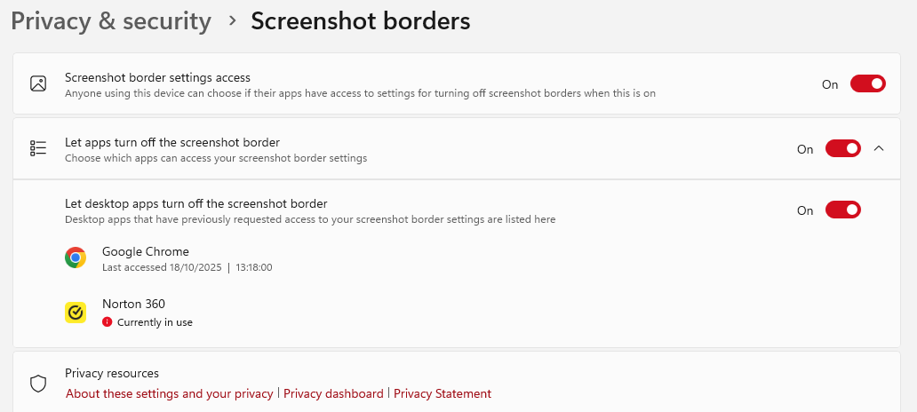

After running Live Update this morning and opening Firefox, I found that I was getting the yellow border around Firefox, a well known indication of screen capture. I went into my privacy and settings to see what might be causing this, and found that Norton 360 was activating the “Screenshot Borders” as shown in my first picture. When I opened the screenshot to examine it further, I found that Norton 360 was also activating a “screenshot border” around the Photos app as well. I further confirmed that this started after the March 31 update, as a laptop that had the immediately prior build of Norton 360 didn’t display this behavior until I intentionally did the update and reboot, at which point it started activating screenshot borders in Edge and Firefox
I found this alarming, and could find no clear way to determine what Norton was doing, what information it was taking, nor a clear way to disable this feature should I so choose. How can one disable this? What information is being analyzed and potentially sent to Norton when this feature is active?

Installed Norton 360 latest update yesterday and I am having the same issue… I hope Norton has not created its own Recall feature…
It has happened in my machines as well–three of them. The Firefox, Edge, and Chrome browsers appear with a yellow border after the Norton 360 update. The yellow border also appears on the Mozilla Thunderbird application.

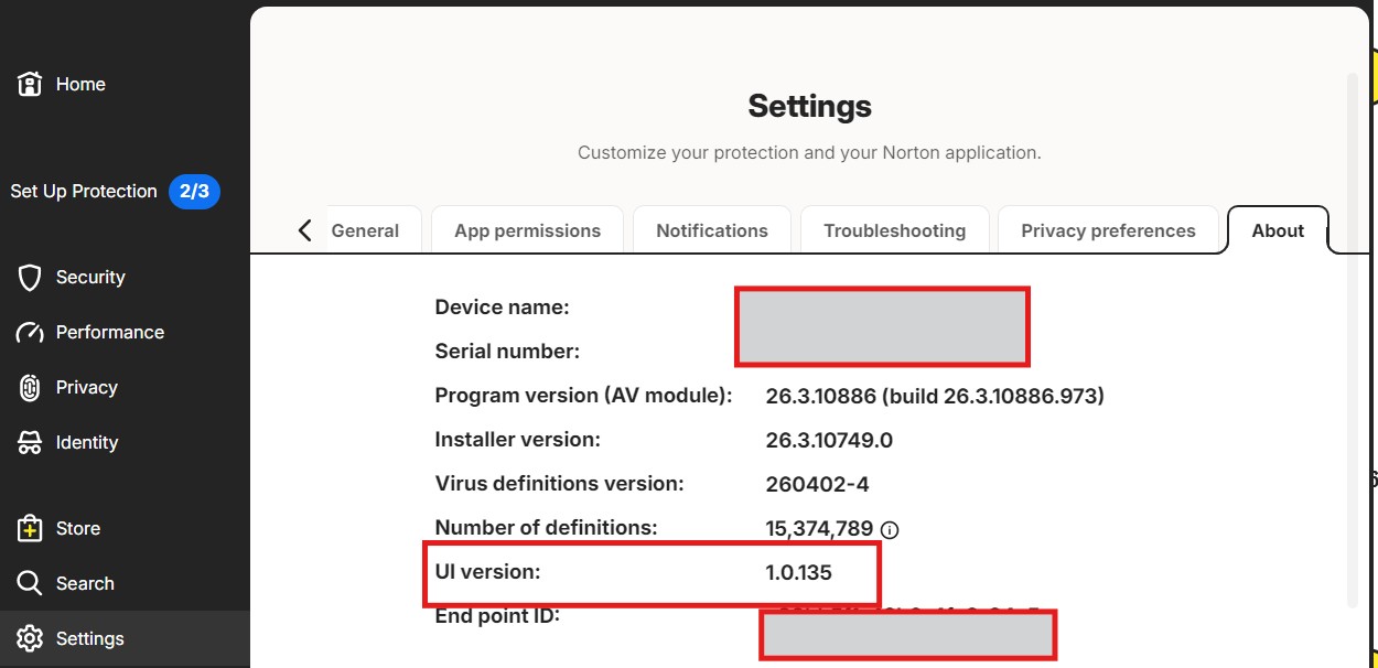

Windows 11 Pro 25H2 Release Preview 26220.7872
Norton 26.3.10886 (build 26.3.10886.973)

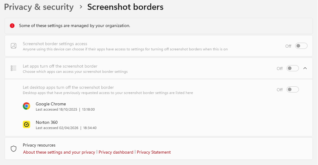

Below are my settings now to remove the yellow bars.
Another setting coming to mind is whether any of you have Co-Pilot enabled on Edge. Also if you have Narrator enabled disable it. High contrast search setting can cause the issue.

So far after a live update on both affected laptops this morning, the issue has stopped
Hi Primetime89, glad you reported the issue. I have exaxly the same builds which I have updated to yesterday and I have the same issue with Yellow Border around my browsers’ windows. Since yesterday, Norton hasn’t released new version so NO FIX as of now. What’s happening with these borders anyway? Is my data breached?
I dont have the borders anymore when i ran live update manually this morning.

@cassius99 What is your Norton version currently installed?
There may not be any change to the version number for a quick fix like this. You can look at the UI Version number. That may be what gets updated for this fix.
I think I found a fix. Just go to your Norton account and remove your device. Norton 360 will say that you are not licenced so insert your serial key again. That worked for me.
Thanks Llun. Seems that worked for me as well.

I have the yellow border around all my web browsers and Norton 360 listed in the Screenshot borders settings. Win11. Yellow borders appeared after yesterday’s update.
