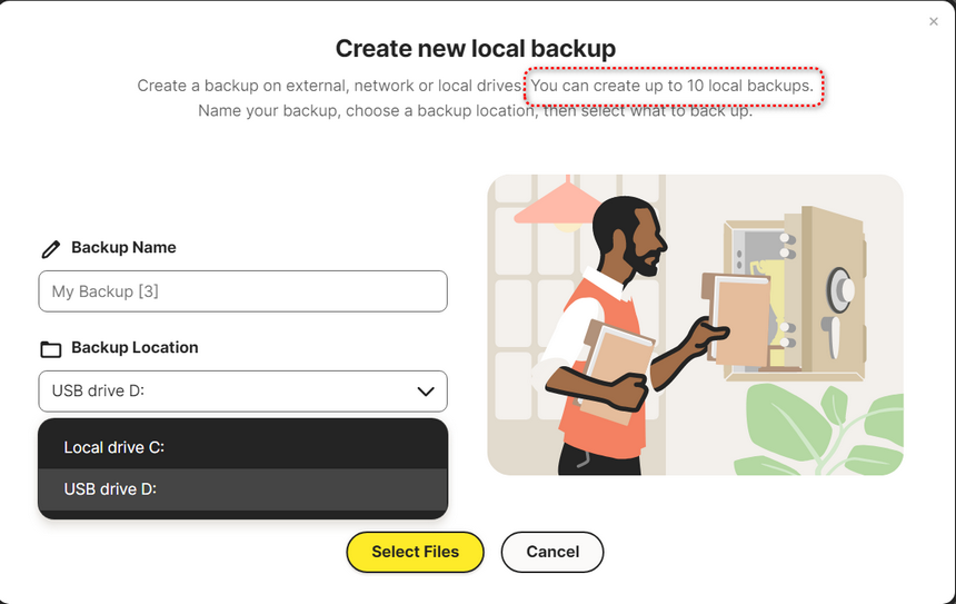

Note: Local Backup offers Create new backup up to 10 backups
