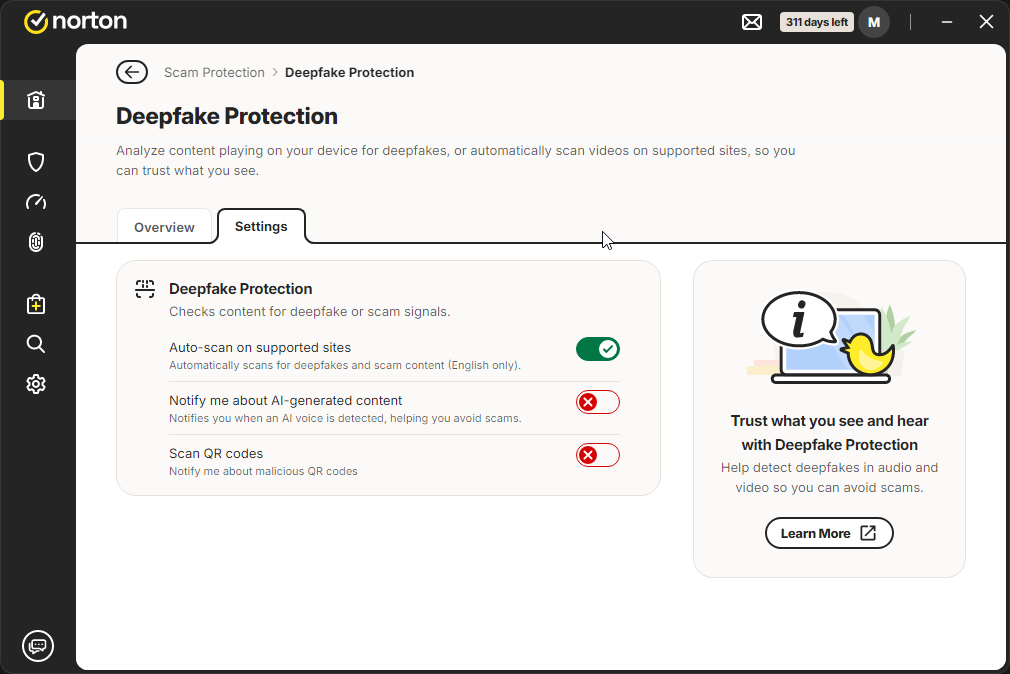

  1. Disable Norton Deepfake Protection.
When Deepfake Protection is turned off, ChatGPT starts and works normally without the issue.
If Deepfake Protection is enabled again, the startup/loading problem returns.

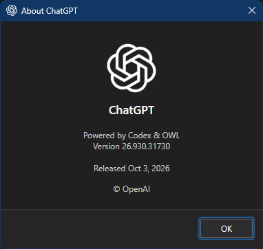

The ChatGPT app identifies itself as:
  • ChatGPT for Windows
  • Powered by Codex & OWL
  • Version: 26.930.31730
  • Release date: October 3, 2026

  1. Enable Norton 360 Deepfake Protection.
  2. Make sure Auto-scan on supported sites is enabled.

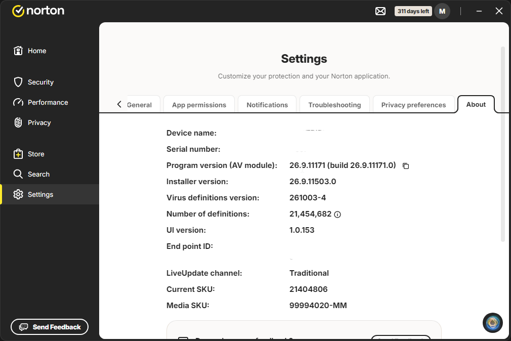

Product & version number:
  • Program version (AV module): 26.9.11171 (build 26.9.11171.0)
  • Installer version: 26.9.11503.0
  • UI version: 1.0.153
  • LiveUpdate channel: Traditional
