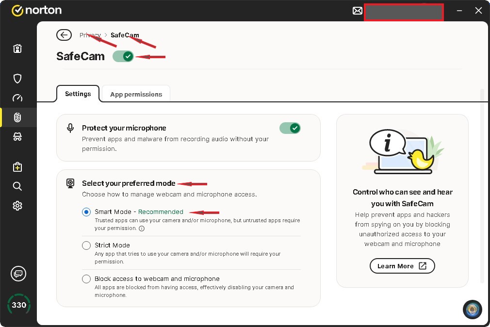

@Peter_B_Shawhan Did you review these settings in Norton related to SafeCam?

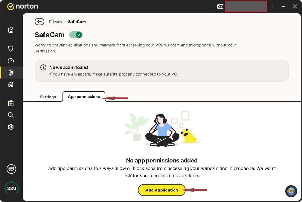

Adding Zoom here may correct part or all the issue:
