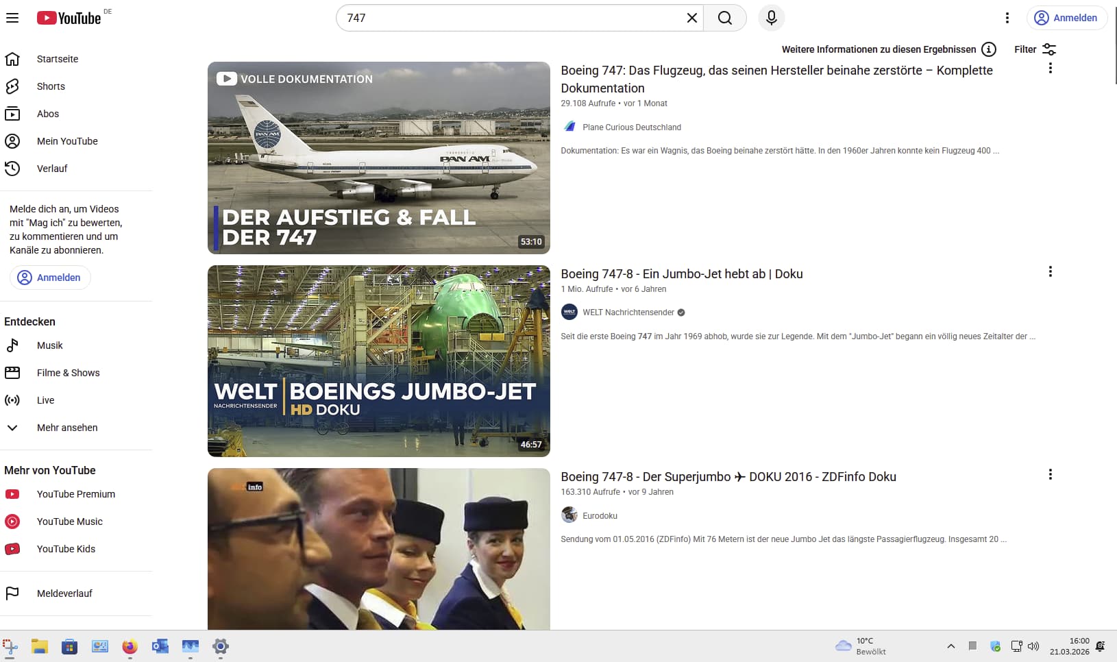

My Norton 360 icon disappears from my taskbar and my Norton 360 window closes when I am going on YouTube video site. If I start a scan it does not interrupt it but I have to click again on the Norton 360 icon on my desktop to bring back the window and the icon in the taskbar. I restarted my computer but I still have the same issue. Repairing Norton did not changed anything too.

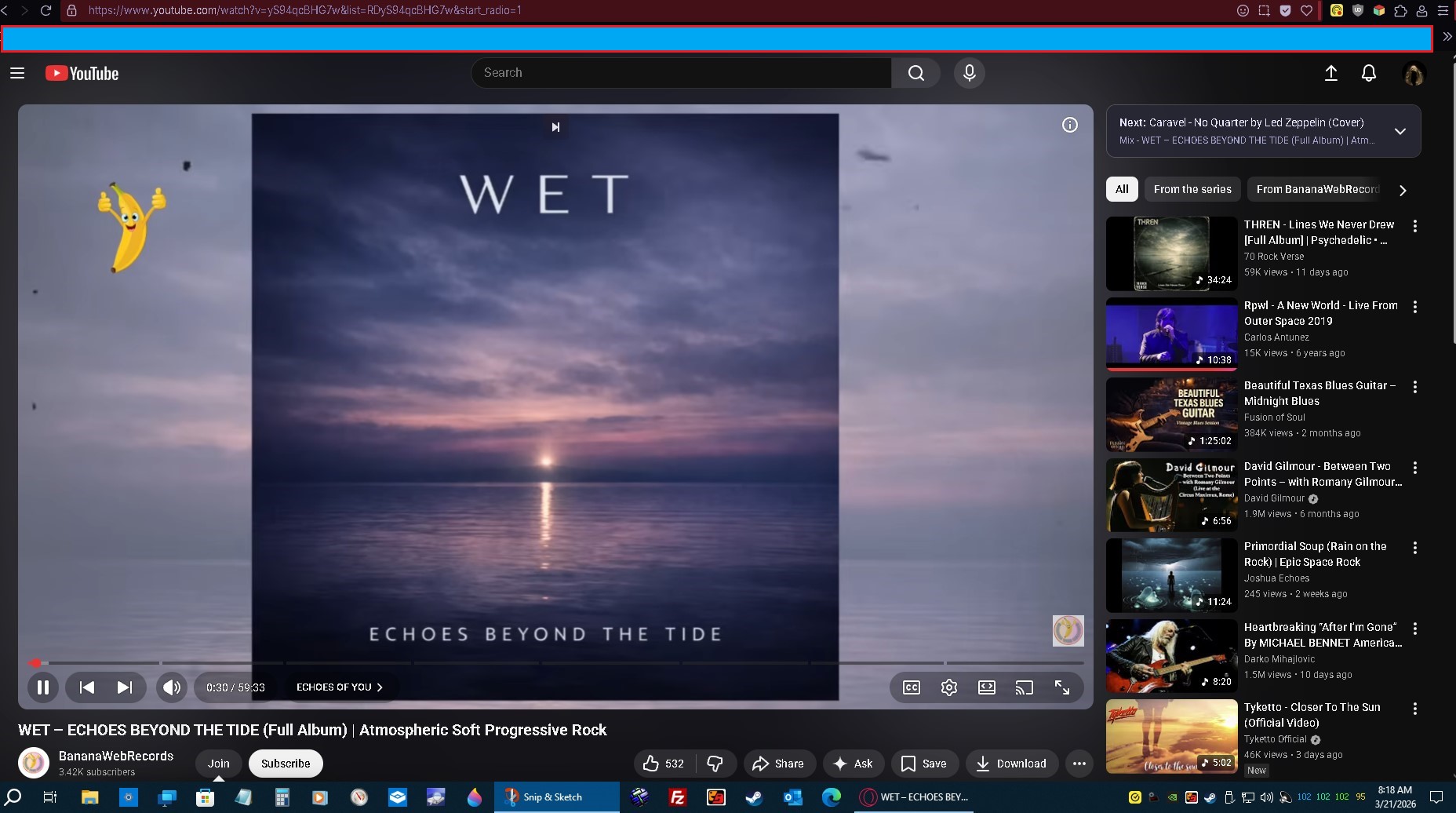

My icon also disappears while youtube is active. After staring Norton from the desctop, it is on the taskbar again, if you use YT, its gone again.

I just posted in another thread that starting today this issue doesn’t even register anything in event viewer. No errors, warnings or information, The icon disappears and Norton is seeming to log out as soon as a video is played on youtube.
In my situation, the icon disappears entirely and does not appear amongst hidden icons.
