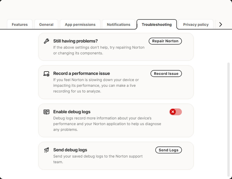

  • Corrupted Norton Installation/Updates: A partial or corrupted software update might cause internal bugs where Norton fails to properly communicate with the Windows network stack.
    • Solution: Try Norton 360 → Troubleshooting → Repair Norton | Reset to Default.
      Note: Reset to Default resets Norton Cloud Backup.

Maybe, document issue via Norton support.
Maybe, Enable debug logs → next time “Norton got changed on its own” → Send debug logs
