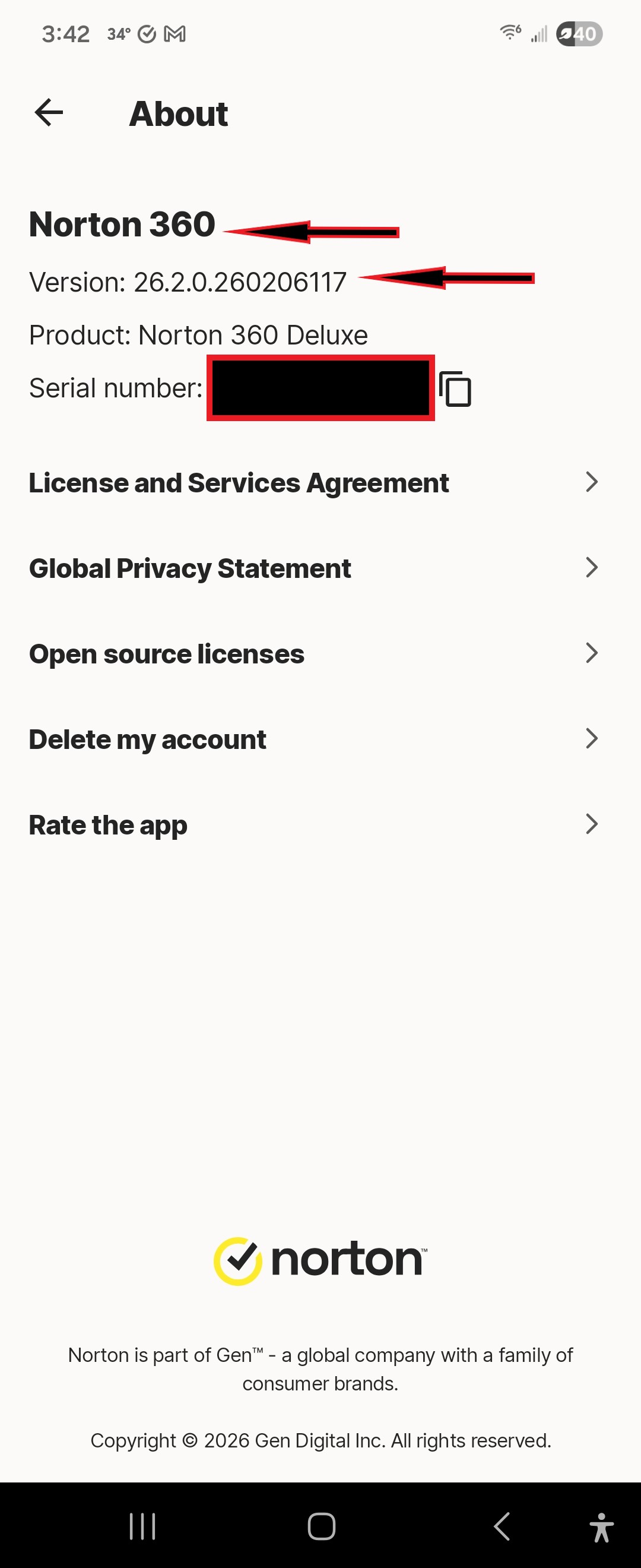

@flattrack72 New version installs without issues my side, Android 16 UI 8.0 . Thinking that Norton is confused about what the minimum version Android it requires, My initial post on the thread is where I get my reasoning from. The version appears to have changed since the OP created the thread as well.
