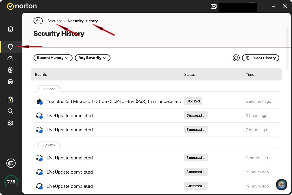

Norton detections history is located in the settings area of the UI, under security history. Other areas to look for logging related to performance and other issues are:
